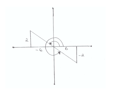

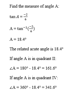

Two possible locations on the coordinate axis for the terminal arm of angle A:
Two possible values for the measure of angle A and the related acute angle:
Can someone please tell me if I did this correctly?

Evangeline101 said:
none
That looks good.
Are you instructed to round to the nearest 0.1° ?
No, I haven't been instructed to do so, but I usually put the rounded number in brackets just in case...
SammyS said:
That looks good.
Anyway, thanks for verifying my answer :)
