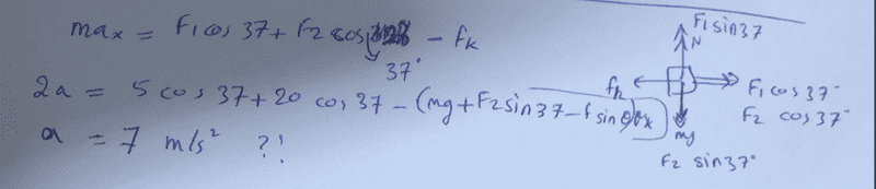

F = ma

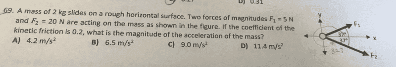

Fr = uK * N
My answer is 7 but it is not one of the choices

In what direction will the force of kinetic friction act? Don't you have to figure that out before you can determine its components?
Edit: Note that you may be better off starting differently. What is the magnitude of the force from F1 and F2 combined?

That does not answer the question.
Let me ask it another way: "Ignoring friction, what is the magnitude of the total force acting on the object?"

to the +ve x-axis
so friction is -ve x-axis
Fx = F1cos37+F2cos37=20 N
What is the magnitude of the total of the two forces? Not just the X component.
Oh... As I understand the problem, we are looking down at the surface of a table from above. Your understanding is that we are looking from the side with one force pulling diagonally up and one pulling diagonally down?
yes
Tried your thought, got wrong answer too
The "looking down from above" interpretation yields an answer that matches one of the choices.
Thanks.Got it . It's choice C
