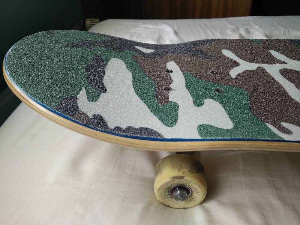

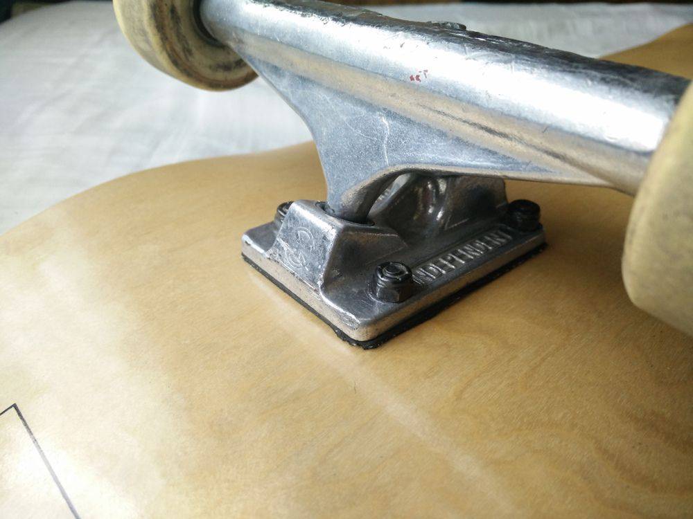

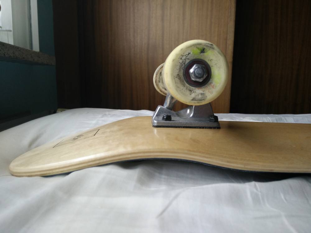

As you can see in the pictures below the trucks are attached to the skateboard with four screws nuts and bolts, with a 2~3mm piece of rubber between the truck and the board. I've always wondered if tightening the screws bolts harder, decreases or increases the strength of the 7-layered plywood. The same question goes for the rubber; does it decrease or increase the strength of the board? What setup will make the board last longest?
My second last board lasted a year before the wood cracked at the trucks, my previous one, one month. So I wonder if this is pure luck, or could my setup have something to do with it.

I cannot see the kingpin clearly in your pictures, guessing that is your board in the photos. Kingpin structure may reduce cracking as well by changing impulse on the board.

Probably little effect in shock absorption but does work to help spread the forces at the interface of truck and board.
The major design problem I see in the photos is the truck is mounted on a curved section of the board. This concentrates the forces on a line across the board where the truck is in good contact with the wood.
This could be by design to act as a shock absorber using the wood as a spring. But wood, like all solid materials, will fracture under repeated flexing. If the board springiness is not needed, a shim shaped to match the board curve to the truck mounting surface should greatly improve reliability.
Since the truck mounting bolts don't see much variation in tension force during use, this part may not apply for skateboards. For general-use assembly the maximum effctiveness of joining fasteners is when the fastener tension applies 1/2 the yield or deforming force of the weakest material. There are tables (probably in MACHINERY'S HANDBOOK) for finding bolt tension versus tightening torque. They are valid for "new, clean, lightly lubricated threads."

It would be interesting to know where the board cracked - towards rear end / forward end of the truck.
The bolts have to be tight enough to minimize movement of the truck in the forward/backward direction, or sideways and minimal rotation of the truck forward backward or sideways when subjected to landing forces.
Maybe your bolts aren't tight enough.
And the truck edge is the stress contact line cutting into the wood causing failure over repeated landings.
Perhaps they are too tight.
And the pre-stress compression of the wood leads to over-compression fatigue failure.
I would consider that the least likely due to the lack of a top plate.
The rubber acts as a point stress reliever and attempts to spread the forces onto a much larger area.
Some movement of the truck does occur due the elasticity - a hard rubber I would think best.
A thin steel plate a bit larger than the truck could spread the contact line over a wider area beyond the truck edges.
