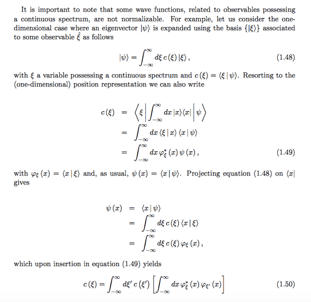

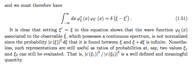

For example, I am following the below proof:
Although the above derivation involves a projection on the position basis, it appears one can generalize this result by using any complete basis. So despite it not being explicitly mentioned here, are all wave functions with any continuum basis non-normalizable?
If your question is reworded to
TheCanadian said:
are all basis functions with any continuum spectrum non-normalizable?
then the answer would be yes.
Yes, because if you have two eigenstates of a self-adjoint operator in the continuous spectrum then
$$\langle a_1|a_2 \rangle=\int_{\mathbb{R}^3} \mathrm{d}^3 \vec{x} \langle a_1|\vec{x} \rangle \langle \vec{x} |a_2 \rangle=\int_{\mathbb{R}^3} \mathrm{d}^3 \vec{x} u_{a_1}^*(\vec{x}) u_{a_2}(\vec{x})=\delta(a_1-a_2).$$
So the eigenfunctions are "normalizable to a ##\delta## distribution" and thus are not normalizable in the usual sense, because they are not square integrable. They don't belong to the Hilbert space but to the dual of the domain (which is also the co-domain) of the self-adjoint operator and thus a distribution (in the sense of generalized function).
