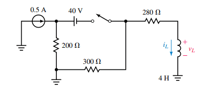

a. What is the energizing circuit time constant?
b. Close the switch and determine the equation for iL and vL during current buildup.
c. What are iL and vL at t = 25 ms?
i = E/R*(1 - e^{-Rt/L})
Circuit schematic with a 0.5 A current source, a 40 V voltage source with a switch, a 200 ohm resistor and 300 ohm resistor to ground, a 280 ohm resistor, and a 4 H inductor labelled iL and vL, with iL shown as a downward arrow.

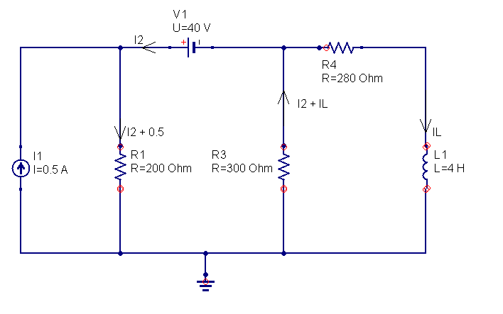

I have redrawn the circuit as below
Circuit schematic with a 0.5 A current source I1, a 40 V battery V1 with branch current I2, resistors R1 = 200 Ohm, R3 = 300 Ohm and R4 = 280 Ohm, and inductor L1 = 4 H carrying current IL, with a ground node at the bottom.
40 - (I2+0.5)200 - (I2 + IL)*300 = 0 -> eq1
-(I2 + IL)*300 - IL*280 - 4*dIL/dt = 0 -> eq2
Are my equations correct?
I tried the following but answer does not match
##40 - (I_2 + 0.5)200 - (I_2+I_l)*300=0 ## -> 1
##500i_2 = 140 - 300i_l ## -> 1i
##-(I_2+I_l)*300 - I_l*280 - 4\frac{dI_l} {dt} =0 ## -> 2
##-300I_2 - 580I_l - 4 \frac{dI_l} {dt} = 0 ## -> 2i
Substituting 2i in 1i
##\frac{di_l} {dt} + 75i_l + 21 =0 ## Solving for il
##i_l = \frac{21e^{-75t}} {75} - \frac{21} {75} ##
a. Energizing circuit time out, i tried to calculate ##\tau##
##\tau = \frac{1} {75} = 0.013## But the answer is 10ms.
There's a sign error when you put the numbers into eqn 1.
40-100≠140.
edit: BTW, this kind of mistake is incredibly common when doing this sort of problem. We ALL do it, all the time. You should just get used to checking for them. It's tedious, but the effort saved by avoiding confusion is worth it in the long run.
Yes, i got the equation as
##i_l = \frac 9 {100}(1- e^{-100t})##Amps
and
##v_l = 36e^{-100t}##
The time constant is 10ms.
