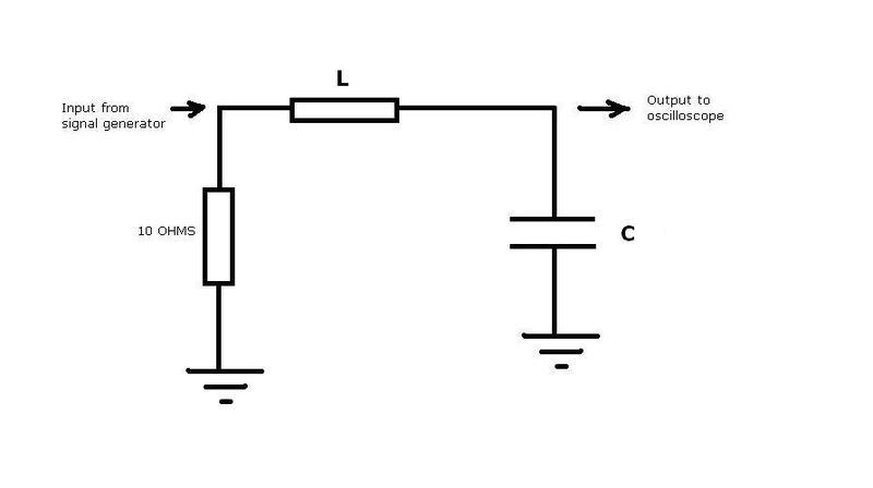

You can try to attract the coil with a magnet. If it attracts, the coil has a magnetic core and all measurements at 1 KHz are meaningless at 1 MHz because magnetic cores change their properties dramatically with frequency.
Air cored coils have fairly constant inductance if they are used well below their self resonant frequency. So, you could get an idea of their inductance with the LCR meter.
Capacitance measured on the LCR meter will also be much the same at 1 MHz.
If you have a signal generator or function generator that works at 1 MHz you can try the circuit arrangement below to check the coil. If the coil and capacitor are resonant, there will be a big increase in output signal at that frequency.
If your coil has an inductance of 21 uH at 1 MHz it should resonate with about 1200 pF.

Thanks vk6kro,
I will try that.
