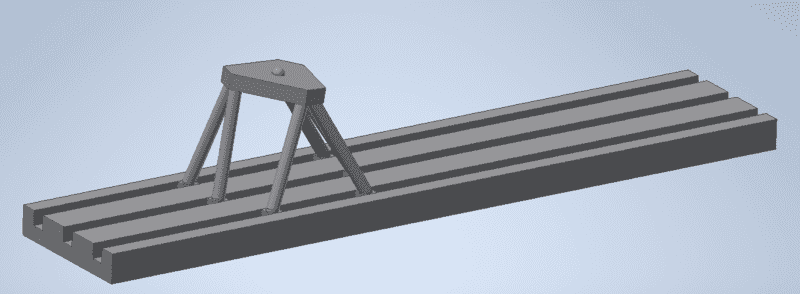

My other consideration is to design a stewart-esque platform which runs on parallel rails, so that the whole platform can slide together whilst the legs can be separated to adjust the height & tilt of the platform. Whilst it would behave differently to a stweart platform, it should be programmable to give the tilts and height adjustment that I am looking for!

Currently consideing this approach, with the 6 feet driven independantly up and down the rails. This is a crude model, the final one would be designed to drop to near enough just above the rails without the arms clipping into things!
Maximum height will be the triangle formed when the two pairs of arms are positioned parallel and directly below the joint. Maximum working range (when at lowest height) would be the full length of rails less the length of the platform assembly. I will need to do some working out to figure out the maximum range in the direction perpendicular to the rails!
Only concern is that the machine might jam up, but I suspect I can make a very basic prototype with wood & rollers to see how it will work out, and what its limitations will be! Might even be able to make it from lego technic...

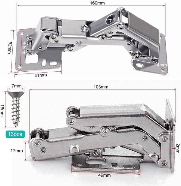

Tangential:
"... the mechanism of a cupboard door hinge (which allows the door to pivot around a point which the hinge isn't actually occupying) ..."
Due care with the kitchen variety, please, as their multiple hinge lines may give a lot of flexure / lateral play...
I've tried to mount a 1/4 carousel under sink drainer behind what had been a dummy drawer front, but 'wibble' in its two near-adjacent hinges let it sag beyond the limited clearance...
;-( Could not use 'roll-out' as would clash with nearby laundry machine. Junior Cat claimed carousel module while I sought options... )
Nik_2213 said:
Tangential:
Design reference please!
