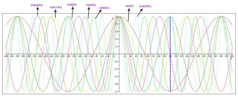

This question just came to my mind and I thought I should confirm it. Are the cosine functions with the same amplitude but different frequencies are totally in phase at any other point other than the origin? The frequency, f, could be 0<f<∞. I'm not sure if the answer is obvious.
Hi,
This question just came to my mind and I thought I should confirm it. Are the cosine functions with the same amplitude but different frequencies are totally in phase at any other point other than the origin? The frequency, f, could be anywhere between 0 < f < ∞. I'm sorry if the answer is too obvious.
I have graphed below some cosines below and to me it looks that the origin is only point where they are totally in phase.
Could you please help me with this? Thank you!
Mathematics news on Phys.org
No. At point x=x0 you have ##\cos(\pi \frac x {x_0} ) = -1## but ##\cos(2\pi \frac x {x_0} ) = 1##.
This doesn't mean x=0 is special - it just follows from the collection of functions you consider. If you consider the set cos(c(x-2)) for different c then they will all line up at x=2.

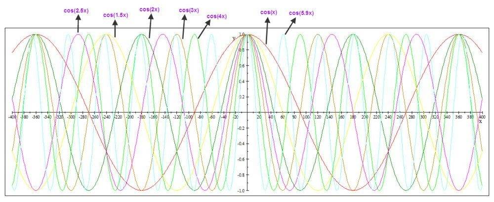

I understand that it's said that a sine or cosine functions are periodic over 2π but it doesn't look like it holds when frequencies are non-integer. I have tried to illustrate my point below.
The cosine function - that is one single function - has a period of 2 pi.
fc(x)=cos(cx) has a period of 2pi/c, but that is a different function for each c.

I'm not sure why @mathman said, "I presume you mean in only one cycle of cos(x)". Because the
the cosine/sine functions with the same amplitude but different frequencies are only in phase at the origin; in other words nowhere other than the origin, i.e. t=0, their peaks or troughs ever match up anywhere over all their cycles where -∞ < t < ∞.
He said it because two cosines whose frequencies are related by a rational ratio will be in phase an infinite number of times.

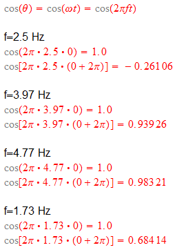

Hi again,
Suppose at π radians the phase of each cosine is measured in relation to cos{2π(1)t} where 0 < f < ∞ and -∞ < t < ∞. It would give you a set of phases for all cosines at π radians with respect to f=1 cosine. You could use any point other than π radians. Now the question is if we would get the same set of phase relationships at any other point along the t axis.
I understand that cosine is an even function and symmetric along y-axis but, for example, if you check, cos(5.9x), https://imagizer.imageshack.com/img922/5073/b2qFGJ.jpg , you can see that the phase differs for -80°, 80°, -360°, 360°, and so on. If on one side curve is going up, on the other side it is going down. It's really confusing. Where am I going wrong?

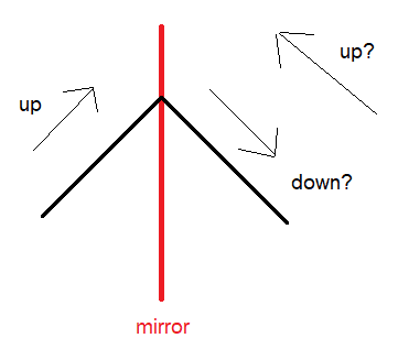

That's exactly what you get from mirror symmetry. Both go up/down together if you "go away from zero".
Thank you.
But they are not going up/down together. One is going up and the other, the symmetric point, is going down. Please check the plot in my previous post.
Could you please also comment on my other question? Thanks.
I don't understand your other question.
That depends on the direction you look at.
Here is a black shape that is clearly mirrored at the red line. Call "up" and "down" what you want.

I didn't phrase my question properly because now I see that it was something else, a related point, which was actually troubling me. I believe that in case of sinusoids two points are considered to be symmetric when their amplitudes and phases are equal. If one point is going up and the other down, the phases are not going to be equal. For example, in this plot, https://imagizer.imageshack.com/img924/9855/rRjJ3A.jpg, you can see that each set of points have equal amplitudes but, as I said earlier, one is going up and the other down which implies different phases.
Let me rephrase the other question. In the picture below, the phase of each cosine is measured at π radians or 180°; the blue line shows the point where the phase measurement of cosines is taking place. For example, the phase of cos(x) is 180°, phase of cos(2x) is 0°, the phase of cos(2.5x) is approximately 90°, phase of cos(3x) is 180°, and so on. Assuming that we are able to measure phase of each cosine for 0 < f < ∞. It would give us a set of phases at t=π radians like this
. My question is as the blue line sweeps through the t axis (or, x-axis) from 0 < t < ∞, would we get the same set(s) of phases at some other point(s)?
By the way, I haven't included negative side of x-axis because one might say as the cosine is symmetric therefore you would also get the same set of phases at t=-π although I'm confused about this point as my starting statement in this post shows.
