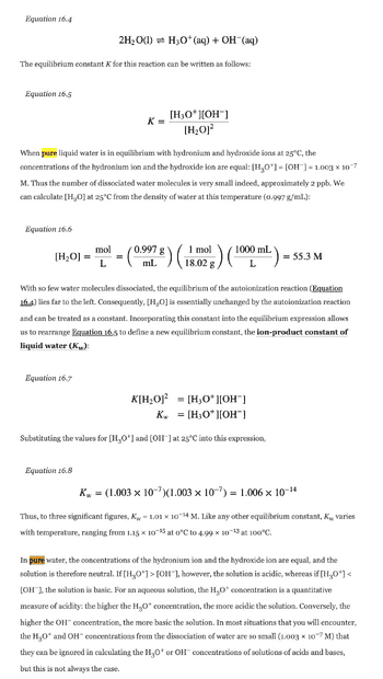

I think one snippet from a book that confuses me is the following
In pure water, the concentrations of the hydronium ion and the hydroxide ion are equal, and the solution is therefore neutral. If [H3O+] > [OH−], however, the solution is acidic, whereas if [H3O+] < [OH−], the solution is basic.
How can it be possible to have differing concentrations of hydroxide and hydronium in pure water?
Won't the pure water have charge?

The point is that [H3O+] = [OH-] for pure water, but when you add acid or base to pure water, you disturb that balance. I commend your dedication to understanding acid base theory.
Borek said:
Where does it say this is a statement about pure water, and not a general one?
The entire quote starts with "In pure water, the concentrations of the hydronium...".
By the way, here is the book itself and you can search for the quote above to see the context around it.

Yes, this is the general point which I understand. I'm trying to understand the details, however.
It still doesn't mean it applies to everything that is written in following phrases.
I think the use of the word "however" shows that the second sentence is very much related to the first sentence.
But I won't debate the writing abilities of the author because what I want is to understand the equation for K_w.

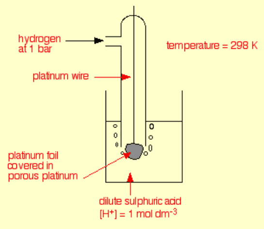

If we place a bar of solid zinc in water, does the water not begin to contain ##\mathrm{Zn^{2+}}## ions?
Is it not possible to do something like this with hydrogen?
Here is a standard hydrogen electrode:
Now, one question I have about this setup is why is it necessary to have that sulphuric acid in the water?
Apparently, there is a dynamic equilibrium between hydrogen gas molecules and hydrogen ions in solution.
$$\mathrm{H^+(aq)+2e^-\rightleftharpoons H_2(g)}$$
Why can't this equilibrium exist without the sulphuric acid?
From what I have read, the platinum catalyzes the reaction.
Anyway, if we could have just pure water (and no sulphuric acid), would not the water become more acidic?
The equilibrium would exist without the sulphuric acid. But [H+] would be much smaller than 1M, so it wouldn't be a standard hydrogen electrode.
To return to your general point, you are possibly confusing infinite combinations with unlimited variability. Consider a reaction A + B → C + D with
K = [C][D]/[A][B ]
If you fix [A] and [B ], then [C][D] = K[A][B ] = constant, call it q.
If you plot a graph of [C] vs. [D], then the line [C][D] = q is (within reasonable physical limits) the locus of all combinations of [C] and [D] that satisfy the equilibrium. These are infinite because there are infinite points in a line, however short. But that does not mean that any point on the plane represents an equilibrium. [C] and [D] are not independently variable. There is 1 degree of freedom - you can move along the line, but not off it.
In the case of the water equilibrium, the same is true. Any combination of [H3O+] and [OH-] that satisfies [H3O+][OH-] = Kw is possible. But if [H3O+] ≠ [OH-], there must be other ions present to maintain charge balance.
K = [C][D]/[A][B ]
NHE requires pH 1 but SHE doesn't.
