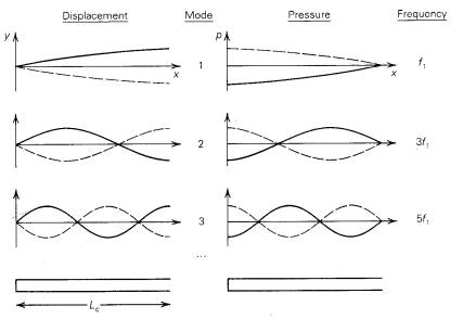

The physics is quite well defined in this area if you simply model the bottle as a cavity with length L - where L (in terms of the bottle) is the distance between the top of the bottle and the surface of the liquid. Fill up the bottle some more and you're reducing L.
In such a cavity, the standing sound waves created have wavelength such that a displacement node (pressure antinode) is at the base of the cavity (the water surface) and the opposite at the opening, as shown in the following image I found via google:
And voila. Shorten L by filling up the bottle, and you're making a shorter wavelength therefore higher frequency :)
Not sure if I explained it very well but, if you're not sure, do some googling on "Standing Waves".

So can i use the laws of waves to prove that the distance between the water surface and the end of the beaker did affect the sound provided. Then use some data loggers to prove that the frequency did increase once the water surface closer to the end of the beaker?
As i am using the same shape of beaker , i think i can take the shape problem as a control variable? thanks so much to answer my annoying question :)

Sort of. The properties of the glass material and the properties of the water both have an effect on the sound.

In the case under discussion, the sound is produced by the vibration of the glass (and the water in it). The frequency (and so the pitch) will depend on the elasticity and mass of the glass as well as the shape and size. The normal modes are characteristic to the glass rather than to the air above the water. Adding water increases the mass and the damping of the system so the frequency decreases, in general, when you add water.
The motion is somehow similar to that of a bell. The pitch of the bell is tuned by slightly reshaping the bell on a lathe. Does not depend on the height of the air column inside the bell.
I'm not so sure that the resonance is due to the air in the glass. The natural resonance of such a small and open ended cavity would be a very high (ultrasonic, even) frequency and the Q would be extremely low (very short reverberation time). It seems more likely to me that the resonance involves the mass of water and the flexing of the stem of the glass or the bowl shaped envelope of the glass. The simplest form of this type of harmonic oscillator is a mass on a spring. The frequency of that oscillation is
1/(2π√(k/m)) where k is the spring constant and m is the mass. That would tie in with the observation that more water in the glass produces a lower note.
Rats - I just read the same basic thing in the previous post. But here it is anyway.
When tuning bells, they make the 'end' of the the bell thinner to raise the pitch and the 'waist' of the bell thinner to lower the pitch. Glockenspiels (and quartz crystals) have the frequency adjusted by making the middle thinner to lower the frequency and the ends thinner to raise it. With a glass of water, all you can do is to vary the mass. but I guess that thinner glasses would tend to produce lower notes than thicker ones.

I really like the observation about the size of the air cavity. I know that the first resonance in a tube with one open end occurs at \lambda/4, so the wavelength will be much larger than the cavity. I started to estimate the cavity dimensions for the wine glasses I used in class, and that reminded me that you get a tone (by striking and running a finger around) with a glass that is full to the brim with water. That seems to rule out the air cavity as having an essential role in sound production. And the fact that you get a tone in an empty glass does the same for the water.
I don't think the stem can be involved in making the tone. You can wrap your hand around it and squeeze to damp the vibration and not affect the tone.
