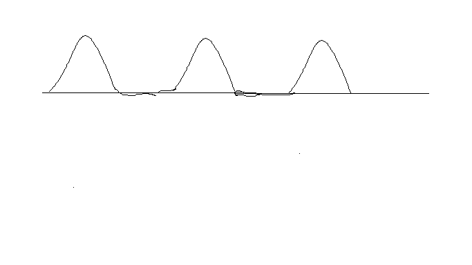

weave is change in something. and I always see harmonics wave that looks like this there is some normal value let's say the height of the water then the height of the water become higher then normal and then lower like that
But do there are an harmonics waves in physics that just going up and then down but don't go lower then the normal value ? something like this

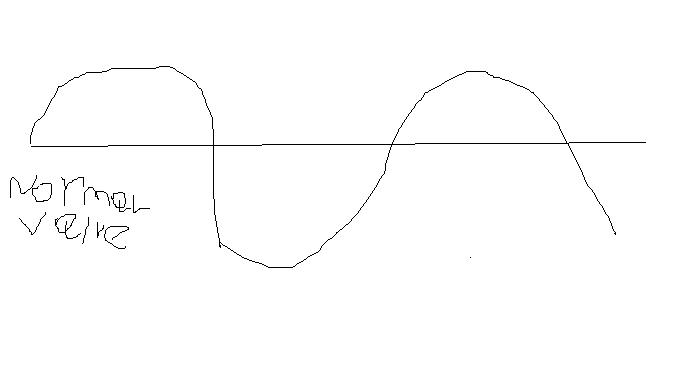

Or even something like that

A full wave rectifier takes a signal that looks like what you have in the first figure and converts it to a signal that looks like what you have in the second figure.
Likes etotheipi, berkeman, Dale and 1 other person
i am not taking about digital signal i mean if there is any weave in nature that behave like that
If I understand your question correctly, you are asking whether there is full rectification occurring without human intervention. I don't know of any cases.

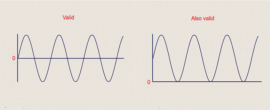

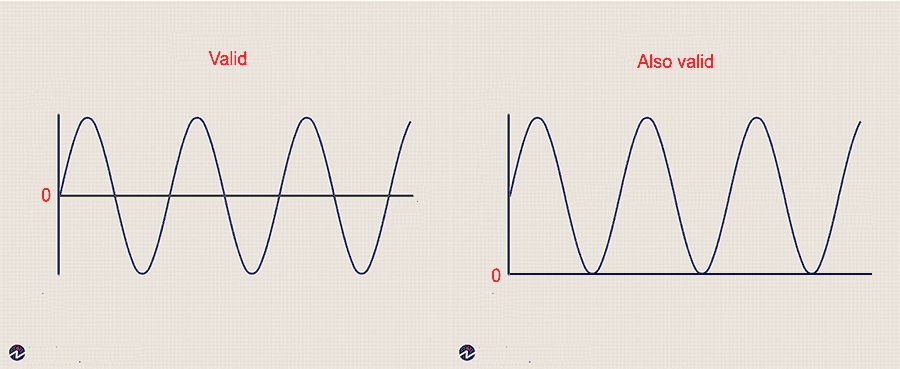

You've defined the "normal value" to be the bottom. You can always do that, even with a sine wave.
Consider a mass and a spring. Initially, the mass is at the zero position. Now you move the mass and let it go. It oscillates around zero, and eventually returns to the zero position.
Now compare that to stretching the spring, but then carrying the whole apparatus up to the second floor before letting it go. Now it oscillates around the second floor elevation which is not the initial zero.
Edit: The second example superimposes a wave solution with a linear height change solution. Superposition is an important concept in physics that you should keep in mind.
Likes danielhaish and sophiecentaur

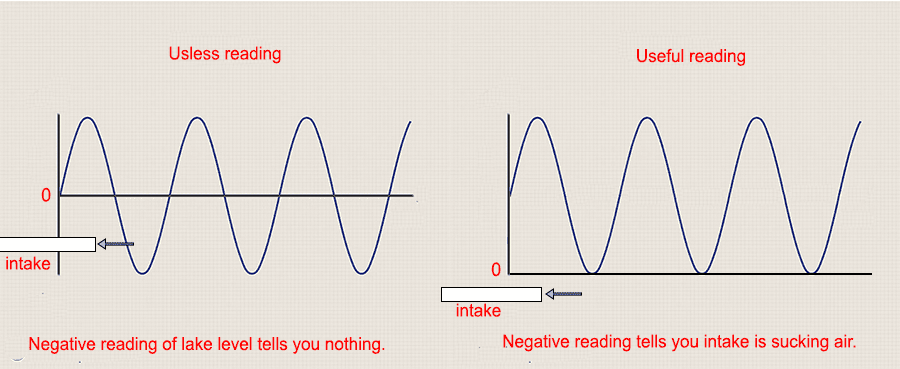

Yes. The point is: that an arbitrary choice, for the convenience of whatever you plan to do.
There are certainly reasons why you might want to set the baseline at the minimum, rather than the median.
A spurious example: an intake pipe, set in a lake, for a water-cooled motor. You don't want it to suck air.
The lake level has an annual rise and fall that approximates a sine wave.
It doesn't matter what the average or median water level is. What matters is the water level at its minimum.
So you set zero to the lowest point on the sine wave. As long as your readings are positive, your intake is under water and cooling properly.

for a natural one which would reflect your "untitled 4" graph, with the peaks present but the troughs removed (but the time still present between them), imagine a pendulum, on a long string. The pendulum is raised and swings down. when the string is vertical, it impacts a horizontal bar halfway down the string. The weight continues to swing, on the lower half of the string, and the upper half of the swing stays still until the weight swings back past the bar. If you were to plot the displacement of the mid-point of the string, which impacts the horizontal bar, it would give you the graph you sketched.
Such a wave wouldn't propagate because, once the string was stationary, the energy would be lost. You could use a loudspeaker to produce a wave with approximately that sort of shape but it would involve a very wide band of frequency components (Fourier series) which would add together during the 'flat' portion of the waveform.
