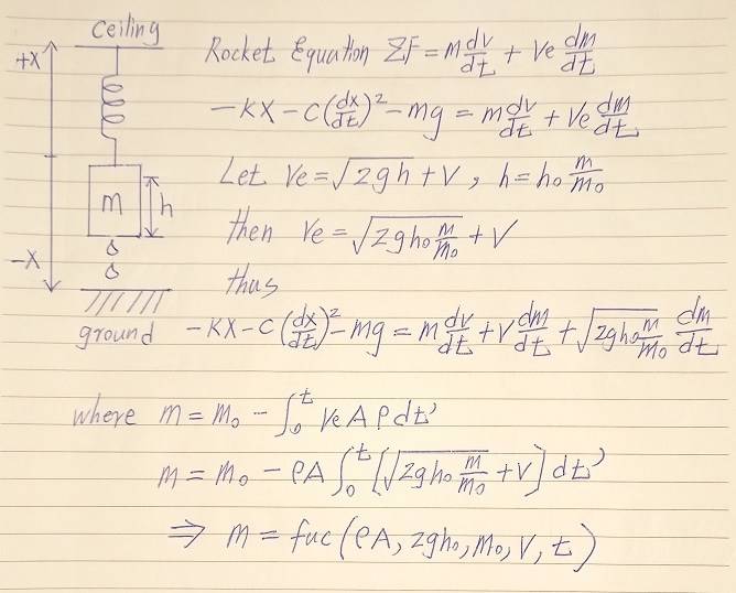

Assuming the system oscillates up and down (I'm not sure if OP means side to side). Is it possible that this is the case, although I made other bold assumptions in deriving the equation? :smile:
Handwritten derivation for a vertically hanging spring-mass system with mass losing exhaust, showing a rocket-equation force balance with spring, damping and gravity terms and the mass expressed as a function of time.

That's interesting derivation. Looks like ##m(t)## is coupled to ##v(t)## which makes the ODE highly non linear not only due to the ##(\frac{dx}{dt})^2## but due to terms ##m\frac{dv}{dt}## and ##v\frac{dm}{dt}##
Delta2 said:
the ODE highly non linear not only due to the (dxdt)2 but due to terms mdvdt and...
Yes, whether the derivation is reasonable, right or wrong, these equations are too cumbersome and complex to be almost certainly impossible to solve analytically, and thus should be completely unappealing to the vast majority of people.
In other words, solving these equations for such a complex system is really a numerical analysis and engineering problem, not a physical one.
