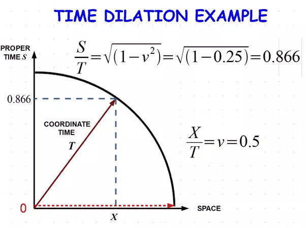

There is a geometrical interpretation of Relativity similar to what you describe:
https://diagonalargument.com/2019/09/15/epstein-relativity-diagrams/
In this interpretation, everything (not just light) advances at the same rate in space-propertime. Only the direction with respect to the space and propertime axes is different. So if you are at rest in space, then you are advancing at the same rate thought propertime, as light is advancing through space.

In relativity you have two different time quantities:
- coordinate time, measured by a clock at rest in the used reference frame
- proper time, measured by a clock moving with each object
Is it the same time dilation that is learned in school right?
Yes, it's the same formula, just visualized geometrically.
In the usual Minkowski diagram you have the coordinate time on the vertical axis, and no direct visualization of proper time.
