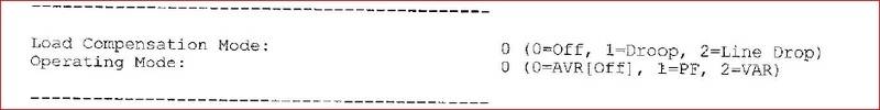

my reason for suggesting look at the Voltage Regulator is they're all too often considered a mysterious black box set up initially by black robed wizards who speak in tongues , never again to be touched by mortals.
I'd guess from this snip of his voltage regulator sheet
that there's no reactive compensation at all dialed in, droop or rise
which with his generators paralleled on the low side of the transformer i'd expect to cause var sharing troubles between them
one machine way in lag and other way in lead, difference going out to the grid
but to make that call one needs to be there and watch the ammeters as he adjusts excitation.
