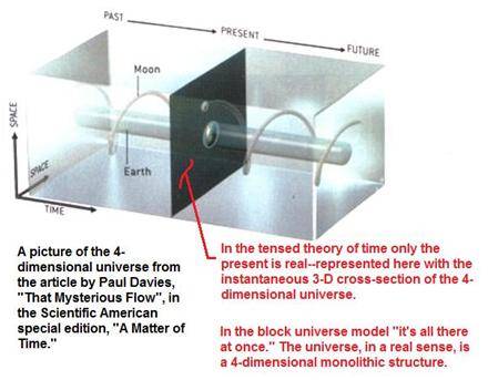

There is an interpretation of special relativity that views the universe as 4-dimensional. Some refer to this universe model as the "block universe." You can google it for more detail. Or I can provide sketches and more discussion if you are interested. Here is a sketch from Paul Davies's book, "About Time." It identifies different ways of understanding time. It is often claimed that Einstein embraced the block universe concept. Davies and others make that claim, and Davies claims that most physicists accept the block universe concept. Certainly his close friend and colleague, Hermann Weyl did, who pictured all objects in the universe as 4-dimensional objects, including our human bodies.
Thus, all objects would be static--in effect frozen motionless in 4-dimensional space. Then how could anything be moving? Answer: No physical objects move at all. Weyl described the situation as the consciousness moving along the 4-dimensional brain of a motionless 4-dimensional body. The consciousness moves at the speed of light along the bundle of neuron fibers, strung out along the 4th dimension for typically billions of miles. It would be kind of analogous to a film strip unwould from its reel, strung out for some extended distance. You move along, your eye focused through a magnifying glass, passing each frame at a rate of around 20 frames per second, viewing the sequence of frames, conveying the impression of evolving visible activity. The whole film strip, all events in time, are all there at once, but your consciousness views the frames in rapid sequence.

Epstein has observers moving along their own worldlines at the speed of light. But, the Loedel diagrams make much more sense. At first glance at a couple of Epstein's diagrams showed one observer moving faster than the speed of light (the time axis of the second observer was rotated more than 45-degrees. And I never did see a diagram with the worldline of a photon shown to clarify that confusion. There was nothing I could see in the diagrams to indicate both observers measured the same value for the speed of light, although I may not have studied them closely enough. It was advertised as relativity made simple--I don't see that.
Some individuals, myself included, like to envision the fundamental geometry of 4D spacetime as including time as an entity on par with the other three spatial directions. In such a framework, a differential position vector \vec{ds} in spacetime between two neighboring events at t,x,y,z and t +dt, x +dx, y +dy, z +dz can be expressed mathematically in component form by:
\vec{ds}=\vec{i_t}cdt+\vec{i_x}dx+\vec{i_y}dy+\vec{i_z}dz
where the i's are unit vectors in the spatial directions.
This is analogous to how we express a vector joining two neighboring points in 3D space. But where is this mysterious 4th time direction that is implied here? Why can't we see into that direction? In any inertial frame of reference, we have complete access to only a specific 3D cut out of 4D hyperspace (and can potentially see infinitely far into any of these three dimensions). The 4th dimension (time direction) is oriented perpendicular to our 3D cut, and, because of our inherent physical limitations as 3D beings, we have no direct access or vision into this 4th spatial dimension.
By analogy, we are like 2 dimensional beings trapped within a flat plane that is immersed in a 3D space. We have no access to the 3rd dimension, except for the 2D cross section that we currently occupy. This 2D cross section may not be stationary in 3D space; it can be moving forward (unbeknownst to us) into the 3rd dimension. If so, as time progresses, we would be sweeping out all of 3D space, and would ultimately be able to sample all of 3D space with our planar cross section. However, at anyone instant of time, we would only have access to a single planar slice out of 3D space.
This is analogous to what we are experiencing in 4D hyperspace. We are 3D beings trapped within a specific 3D slice out of 4D spacetime. This 3D slice is unique to the particular inertial reference frame we currently occupy (i.e., our rest frame). We have no access or vision into our own 4th dimension, except for this 3D cut. The cut is not stationary; it is moving forward (unbeknownst to us) into our 4th spatial dimension (at the speed of light, see below). As time (measured by the synchronized clocks in our 3D reference frame) progresses, we are sweeping out all of 4D spacetime, and will ultimately be able to sample all of 4D spacetime with our moving 3D cut. However, at anyone instant of time, we only have access to a single 3D cut out of 4D spacetime (a 3D panoramic snapshot). Finally, different inertial reference frames in relative motion possesses different 3D cuts, and different time directions perpendicular to the 3D cuts.
