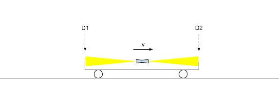

Is my understanding correct that if we have a moving vehicle moving to the right at speed v, as above, with a light source in center going in both directions, that (upon emitting the light at time T), a detector at D1 & D2 would both detect light reaching it at T2? (even though in the time it takes for the light to travel, the distance to D1 has shortened & the distance to D2 has grown?)
According to which frame of reference?
Are the detectors attached to the cart? And which frame's definition of "at the same time" are you using? The answer to your question depends on your answers to both these questions.
Detectors are attached to the cart & moving with the cart
As for frame of reference, suppose we had an infinitely precise clock located at D1 & D2, synchronized; would it register the same value T2? (if I then walked over to them & looked at them?)
So, also attached to the cart?
marcosdb said:
synchronized
But synchronised in which frame? Synchronised with clocks on the ground? Then no. Synchronised with clocks on the cart? Yes.

marcosdb said:
Synchronized to each other (both clocks on the train, moving), so I guess the answer as to which frame is the cart's frame
Given that, if we stop the clocks at the moment the light reaches them (i.e. take a reading on an LCD display), the expectation is that they would have the same number, correct?
Yes.
However, if you have clocks on the ground that are synchronised in the ground frame and just happen to be in the same places as your detectors when they trigger then those clocks will not show the same time, for the reason you gave in #1.

Got it, that makes sense & confirms my understanding (apologies for not making clear that all references were to cart frame & not ground frame, and that the cart was moving at velocity v in relation to ground frame)

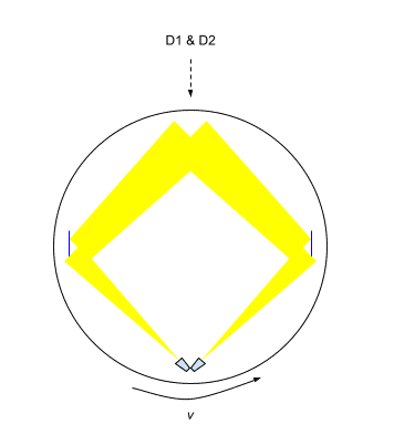

Why is it, then, that when we put this in a circle (Sagnac effect), we don't have the same expectation?
The Wikipedia article reasons that "the light has to travel further as detector is moving away/towards", which seems to only be true in relation to the lab frame; but the detector is in the disc frame, where it would seem, as a parallel to this:
PeroK said:
There is no such thing as a "moving" vehicle. The vehicle may be moving to the right at speed in the ground frame. In the vehicle's frame, it is not moving.
the disc would "not be moving" (in the disc frame, where the detector is), and as such we would expect the 2 beams of light to reach at the same time (in the disc frame)
The speed of light is the same in all inertial frames of reference. A rotating frame is not inertial. And there is no symmetry between frames here - one frame is rotating and objects at rest will feel centripetal forces while the lab frame will not. Furthermore your detectors are co-located so there's no room for questions of simultaneity. The light either arrives at the same time or it doesn't.
I would advise getting more strongly to grips with inertial frames before attempting to work with non-inertial ones. @robphy's suggestion of drawing a displacement-time graph is an excellent one - it's the first step to Minkowski diagrams, which IMO are the most powerful tool for understanding special relativity.

So you can help un-confuse me, then?
Why is the spinning disc (with an emitter & 2 detectors, all at rest with respect to each other) not the same as the train (with an emitter & 2 detectors, all at rest with respect to each other)?
What is the difference?
The spinning disc is accelerating, for one thing.
Does this mean, then, that if I have a fiberoptic cable running east-west from point A to B on the surface of Earth, that it actually takes longer for the signal to go from A -> B than B -> A?
Proper acceleration. It is the acceleration measured by an accelerometer.
In the spinning disk the accelerometer attached to the disk measures the centripetal acceleration, while an unattached accelerometer measures no acceleration. The attached and unattached accelerometers are not equivalent.
For the train both accelerometers read zero. They are equivalent.

But then you must describe anything in the rest frame of the cart. For this you must do the Lorentz transformation with boost velocity ##v## of my posting #5. NOTE that I had made a mistake before and interchanged the labelling of the detectors. It's now corrected.
The events of the light signal arriving at detectors D1 and D2 are
$$x_1 = \begin{pmatrix} c t_1 \\ -L-v t_1 \end{pmatrix}=\begin{pmatrix} L/(1+\beta) \\ -L/(1+\beta) \end{pmatrix},$$
$$x_2=\begin{pmatrix} c t_2 \\ L-v t_2 \end{pmatrix}=\begin{pmatrix} L/(1-\beta) \\ L/(1-\beta) \end{pmatrix},$$
where ##\beta=v/c##.
The boost matrix reads
$$\hat{\Lambda}=\begin{pmatrix}\gamma & -\beta \gamma \\ -\beta \gamma & \gamma \end{pmatrix},$$
where ##\gamma=1/\sqrt{1-\beta^2}##. Thus the events in the rest frame of the cart are
$$x_1'=\hat{\Lambda} x_1 = \gamma \frac{L}{1+\beta} \begin{pmatrix}1+\beta \\ -1-\beta \end{pmatrix} = \gamma L \begin{pmatrix}1 \\ -1 \end{pmatrix}=L' \begin{pmatrix}1 \\ -1 \end{pmatrix},$$
where ##L'=\gamma L## is the distance of the detector from the origin as measured in the rest frame of the cart (length contraction!).
Further
$$x_2'=\hat{\lambda} x_1 = \gamma \frac{L}{1-\beta} \begin{pmatrix} 1-\beta \\ 1-\beta \end{pmatrix} = \gamma L \begin{pmatrix} 1 \\ 1 \end{pmatrix} = L' \begin{pmatrix} 1 \\ 1 \end{pmatrix},$$
i.e., in this frame the light signal reaches both detectors at the same time, ##t'=L'/c## as it must be.
