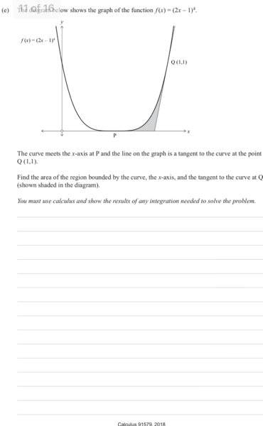

See attached.
Ok so the first thing you want to do is find the equation of the tangent line which is done in the usual way to get ##y=8x-7##. This cuts the ##x## axis at ##x=\frac{7}{8}## so we know the upper limit of the integral to calculate.

It is asking given we have ##f(x) = (2x-1)^4##. The curve meets the ##x##-axis at a point ##P## and the line on the graph is a tangent to the curve at the point ##Q(1,1)##.
Find the area of the region bounded by the curve, the ##x##-axis, and the tangent to the curve at ##Q##.

Ok I found the equation of the tangent curve in the standard way to get ##y=8x-7## which cuts the x-axis at ##x=\frac{7}{8}##.
To find P I found the x coordinate Of the turning point which is ##x=0.5## so now we have our bounds of our integral so we just calculate ##\int_{0.5}^{7/8} (2x-1)^4-8x+7 \; dx##.
I get ##0.5862##.

But in the figure I clearly see there is a part of the integral between 7/8 and 1
And I also see the integral between 0.5 and 7/8 is not how you describe it...:rolleyes:

P is the point where the curve meets the x axis. Can you find it?
Yes it’s ##x=0.5##.
Good. That is the lower bound of the integral. What is the upper bound ?
I’m thinking it’s where the tangent function cuts the ##x##-axis which is when ##8x-7=0##, or ##x=\frac{7}{8}##.
Oops no it isn’t that will be ##x=1##.
So that means I solve ##\int_{0.5}^{1} (2x-1)^4 -8x + 7 \; dx## in which case I get ##0.6##?

I can just calculate ##\int_{0.5}^{1} (2x-1)^4 \; dx=0.1##.
Then calculate ##\int_{7/8}^{1} 8x-7 \; dx=0.0625##.
Now take the difference to get ##\frac{3}{80}=0.0375##.
As long as you see that there are two parts, things go fine -- and that's the important part of what you've learned from this exercise.
