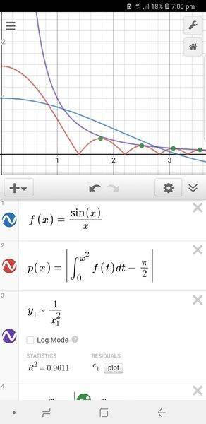

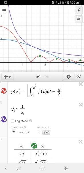

After playing around with Wolfram a bit I discovered that the peaks of ##Si(x^2)-\pi/2## occur at ##x=\sqrt {n\pi}##, with the first occurring at ##x=\sqrt \pi##, the next at ##x=\sqrt {2\pi}## and so on. I decided to plot the coordinates of several maximal turning point and modeled a function to match the points. As it turns out ##1/x^2## actually does match the trend of the decreasing amplitudes almost perfectly. Does that mean that ##Si(x^2) - \pi/2## will actually converage? Please see below a comparison of a model using ##1/x## vs ##1/x^2##.

Desmos app?
Yeah I used the Desmos app for the graphing and modeling
