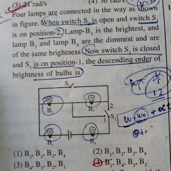

I have got the right answer by assuming certain values of the resistors . But I would like to know whether this question can be done logically without assigning numerical values to the resistors .
Initially when S2 is open and S1 is on position 2 , all the resistors are in series .Same current flows through them . The one with higher resistance will have higher power dissipated and will flow brighter .From this I concluded R2>R1>(R3=R4) .
Now S2 is closed and S1 is on position 1.This makes R2 in parallel with R1 .
Now I assigned some numbers to the resistors such that R2>R1>(R3=R4) and checked the respective i2R values .Then compared it with their initial i2R values .
Could someone suggest an alternative/faster approachwhuch requires lesser calculation to solve this problem .

Jahnavi said:
1.This makes R2 in parallel with R1**R3 .
In the new circuit, current is same for two bulbs (B1 and B4).
Which is brighter?
B3 will receive less current than B4 and R3=R4.
Which is brighter?
Voltage across B2 and B3 is same, but R2>R3.
Which is brighter?
What is the descending order then?

Wow ! Impressive reasoning :approve:
Exactly what I was looking for :smile: .
You have taught me a very nice way to think in such type of problems .
