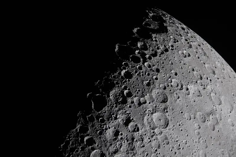

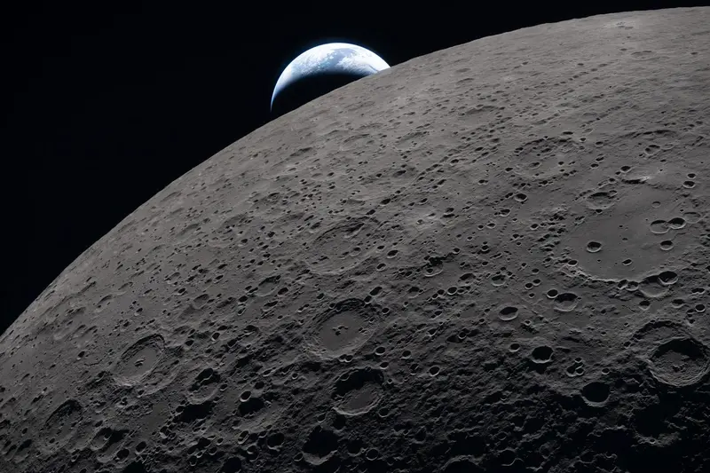

Some gorgeous photos here:
Artemis II Lunar Flyby (NASA)
Quote: "The first flyby images of the Moon captured by NASA’s Artemis II astronauts during their historic test flight reveal regions no human has ever seen before—including a rare in-space solar eclipse. Released Tuesday, April 7, 2026, the photos were taken on April 6 during the crew’s seven‑hour pass over the lunar far side, marking humanity’s return to the Moon’s vicinity."
https://www.nasa.gov/gallery/lunar-flyby/
Examples:
A Setting Earth
Shadows at the Edge of Lunar Day
Shadows Across Vavilov Crater
They got better Moon photos than me!

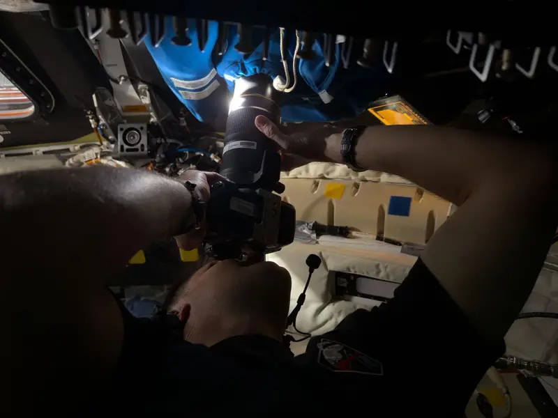

Look, here is one of the upstarts taking photos:
Photographer at Work
I think this is close to cheating; he was one lucky dude and got really, really close to his subject (the Moon), and furthermore he is enjoying the benefits of zero gravity.
Bah! And I bet he is using image stabilization too on his camera. I'm telling you, he had it easy.
(I'm only joking, of course
Source: https://www.nasa.gov/image-detail/amf-art002e009295/Page said:art002e009295 (April 6, 2026) – Astronaut Jeremy Hansen captures an image through the camera shroud covering window 2 of the Orion spacecraft. The camera shroud, essentially a curtain with a hole for the lens to pass through, is used to prevent light from the cabin from reflecting on the windowpanes.
Image Credit: NASA

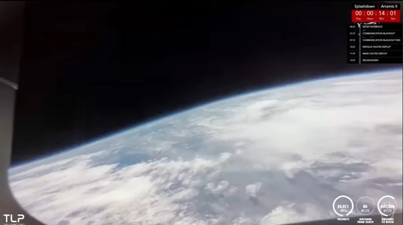

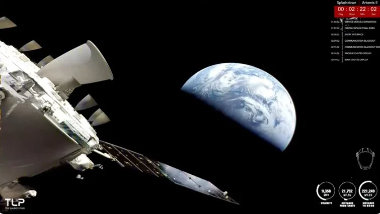

Some snapshots taken from the live stream. Times as recorded on my cellphone. GMT+2
23:49
01:54
02:07
02:09
23:49
01:54
02:07
02:09

I happened to hear about this video when listening to a video on a completely different topic.
It was warmly recommended by a youtuber I trust, so I share it here
Explaining the Most Important Artemis II Photos (Hank Green)

He mentions about ten minutes into the video in post 88 about the bright ring around the lower part of the earth, and he didn't seem to know what it is. I could be wrong, but I think that one is obvious=it's Rayleigh scattering from the earth's atmosphere. (about 20 or 30 miles of atmosphere on a 4000 mile radius).That's what still lights up the moon a little during a full lunar eclipse.
and to add to my post 75 about the photos of post 66, and the mention of the eclipse: The astronauts from what we can see from these photos saw two types of solar eclipses: One caused by the moon and the other by the earth. The moon as seen from earth did not have a lunar eclipse, as far as I know, and the earth did not get a solar eclipse during this period either.
