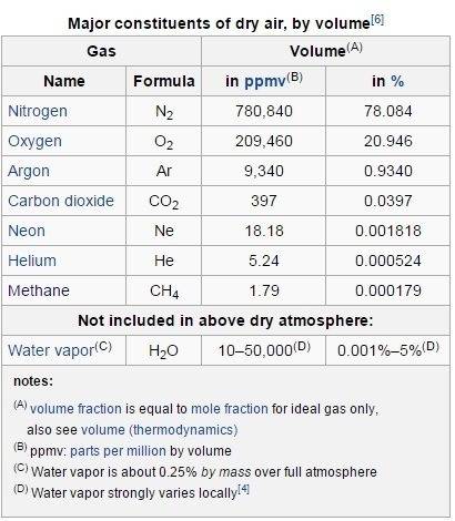

Dear PF Forum,
Our atmosphere consist of 78% N2, 21% O2, 0.9% Argon, and other...
https://en.wikipedia.org/wiki/Atmosphere_of_Earth

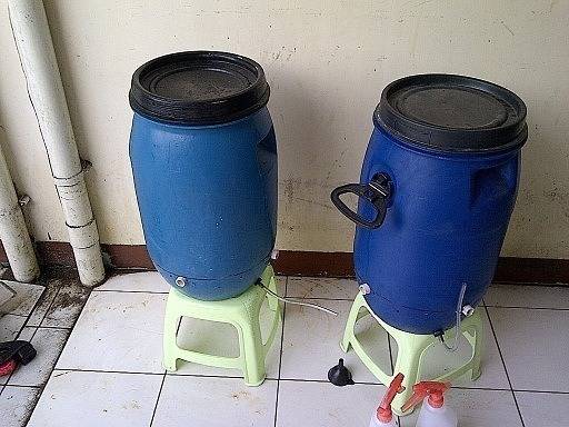

Actually, I'm studying and doing composting. I just want to know how do we introduce oxygen. Will the oxygen (since it's lighter than CO2) enter the bin from the upper hole and carbon dioxyde expelled from the lower hole. But that's for other thread.
as a quick response ... not likely, for a significant reason, can you think what that may be ?Dave
Okay...
Because it seems that the atmosphere is mixed, CO2 (very small amount of it), N2 and O2 (and Ar) they are all mixed and scattered not layered.
Second, I think the gas pressure inside the composter (because there are some chemical reaction in it, bacteria digesting) is higher than the atmosphere, so gas will be expelled from both lower and upper hole.
I think only after the reaction diminished and the pressure inside the composter is lower than the atmosphere , then the Oxygen (along with nitrogren, CO2) will enter the composter from the upper hole (depends on the buoyancy of the gas inside the composter).
That may have an effect, but I was thinking of something more significant ... have another think about processes occurring in the compost pile

They say (I don't know, I've never actually researched it. I just read it in the net) that the composting process is the reverse of photosynthesis. That is
C6H12O6 + 6O2 -> 6CO2 + 6H2O + heat.
Someone said in PF forum, that the reverse of photosynthesis is true, but the process is not that simple, it involved nitrogen and some other element.
Okay...
So the composting expelled CO2 and water,
But my composter bin, I think, is for anaerobic composting.
So, it does not expleled CO2 and water. Instead it expelled CH4 and H2S.
But before I go further, let me give you the atmosphere facts first.
By volume the atmosphere contains:
N2 78.08%
O2 20.94%
Ar 0.93%
CO2 0.0397%
the other Ne, Helium, Methane are too small fraction.
List of molecular weight compared to H -> 1.008. I divide those number by Hydrogen weight, so it will be an easier conversion.
Nitrogen: 27.8
Oxygen: 31.75
Argon: 39.63
CO2: 43.66
Multiply those numbers by volume divided by total volume divided by Hydrogen weight, I have the weight of the Earth atmosphere is 28.74 times of the weight of Hydrogen.
The weight of CH4 compared with H is 15.91
The weight of Hydrogen Sulfida compared with H is 33.82
Okay, now back to your question:
davenn said:
I think I stick to my earlier answer. The gas in the composting will be expelled IF the pressure in the composter bin is higher than the atmospheric pressure, not matter what gas inside. I've already calculated the density of the gas and atmosphere. But on second thought I think that doesn't matter. Only the pressure in the composter bin matters.
If I were a detective, I would have lost this case. I'm sorry, I'm lost here. What do you think why the oxygen is not likely enters the composter bin from above? Is it gas pressure?
Thanks
Steven

I know, I know! (raising hand)
Heat. The composting process is exothermic. A lot of heat is produced; a hot pile can exceed 150F. This is generally desired, to kill weed seeds and pathogens.
All gases will tend to enter the bottom (or sides, if the pile sits on a surface of low porosity) and exit the top.
Yeah, that's what I guess, too. The pile produces heat, and the air pressure in the chamber/composter is higher than the atmosphere.
But, no matter how. The gas will exit from top and bottom, I think.
