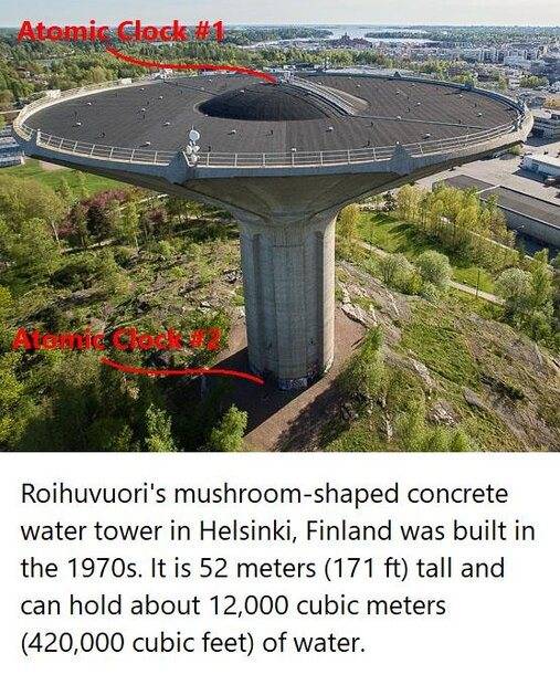

Would a test with two atomic clocks in the great reservoir of Helsinki help to elucidate the problem?
What would you want to show with such a test?
Peter,
Thank you for your interest!
I think if the atomic clock is an accelerometer, the readings of the clocks placed at the base and top of the reservoir will not change depending on the variation in the mass of water contained in the reservoir.
It would be great to be able to do the test with gravimeters too. But the variation in the volume of water may not be enough.

An atomic clock is not an accelerometer. The tick rates will vary because the gravitational potential at the top of the tower will vary as water is added.
The great thing about atomic clocks in fact is that they are pretty insensitive to external influence and thus provide the amazingly accurate definition of the second in the SI. The stability might be topped soon when the "nuclear" Thorium clock becomes as accurate as the atomic clocks.

Would it be useless and expensive to put this consolidated fact to the test?
What problem?
Please try to be clear in your descriptions. We are physicists, not psychics. We cannot read your mind.
What it the problem you are trying to elucidate and how would atomic clocks on the water tower help?
Clocks are not accelerometers, we already covered that.
dom_quixote said:
You could do something similar, measuring gravitational potential instead of gravitational acceleration.
What would be the knowledge you would expect to gain from such an experiment? I mean, what is the point or the hypothesis that it would test?
