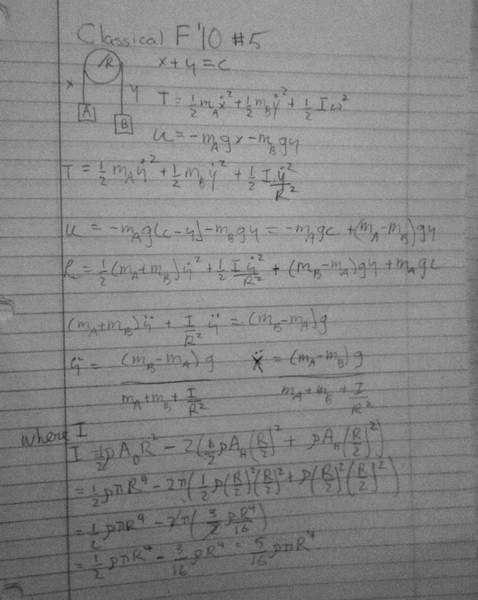

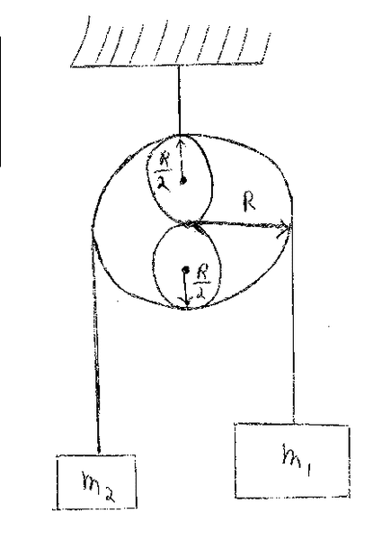

A system consists of a pulley and two masses m1, m2 haning from it as shown in the figure. The pulley is a disk of radius R with constant mass density that has two circular hole with radius R/2. Find the angular acceleration of the pulley.
Figure attached.
L=T-U
[itex]I=I_{cm}+mh^{2}[/itex]
The solution is attached.
I'm not interested in knowing if my calculation for the moment of inertia is correct which is found at the bottom of the solution.
  • Hand-drawn diagram of an Atwood-type pulley: a large disk of radius R hangs from a ceiling, with two smaller circular holes of radius R/2 removed, one above and one below the center. Masses m2 (left) and m1 (right) hang from the rim by strings.

  • Handwritten Lagrangian derivation on lined paper for an Atwood-type pulley system with masses A and B, with equations for kinetic energy T, potential energy U, and the moment of inertia I.
In the first equation for I at the bottom of the page, shouldn't the last term be negative? (Never mind, I missed seeing a set of parentheses!)
It all looks good to me.
Ooops I made a typo. I meant to say that I'm interested in knowing whether or not my moment of inertia is correct.
Oh cool TSny you read it how I meant it.
