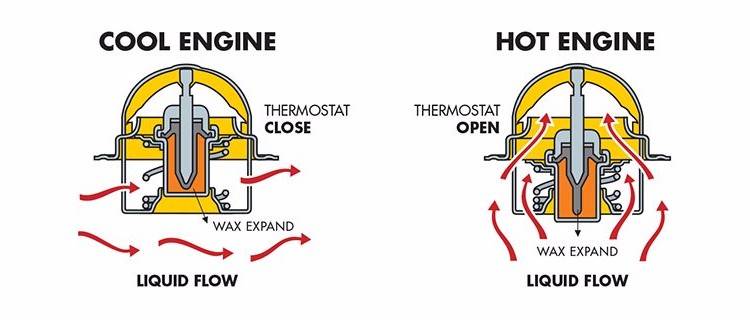

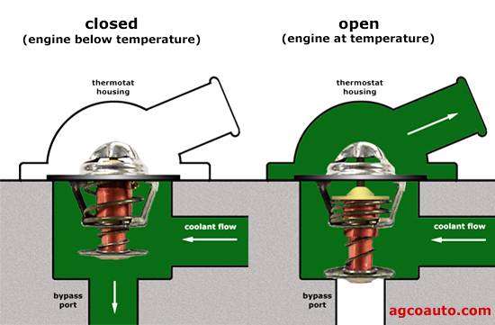

I was wondering what this made me think of: This is exactly how a thermostat works on every combustion engine, even today where mechanical controls have been eclipsed by electronics.
Note in the second figure how the expansion of the wax forces the pin out of the cylinder (or, in this case, actually pushes the cylinder out against a spring since the pin is fixed).

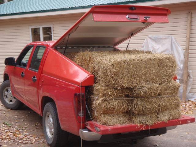

I wish that I had thought to take the ideal gas law into account when sizing the gas struts for this truck topper. The published force ratings for these automotive gas struts is at a temperature of about 70 deg F. These struts held the lid up at temperatures above 40 deg F, and did not hold it up at temperatures below 35 deg F. At -20 deg F, the struts were close to useless. So I kept a stick handy to prop up the lid in cold weather.
More information on this topper in this thread: https://ecomodder.com/forum/showthread.php/modding-06-gmc-canyon-17070.html.
