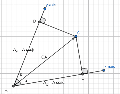

Must the axes of the 2-d coordinate system used in vector resolution be perpendicular to each other?
Hello,
This question is with regards to the discussion around page 56 (1971 Edition) in Anthony French's Newtonian Mechanics. He is discussing the choice of a coordinate system where the axes are not necessarily perpendicular to each other. Here is the summary of what I read (as applied to vectors in a two-dimensional plane):
Vector A makes the angles α and β with two coordinate axes (we'll still call the axes ##x-##axis and ##y-##axis respectively) not necessarily perpendicular to each other (i.e. α+β is not necessarily π/2). Then, ##A_x = A\cdot\cos\alpha## and ##A_y=A\cdot\cos\beta##, where ##A_x, A_y## are the magnitudes of the ##x, y##-components of ##\vec{A}## respectively. In the generalized two-dimensional case, we have the relationship ##\cos^2\alpha+\cos^2\beta = 1##.
I have redrawn the accompanying figure:
How does French arrive at the *generalized* relationship: ##\cos^2\alpha+\cos^2\beta = 1## in two dimensions and ##\cos^2\alpha+\cos^2\beta+\cos^2\gamma = 1## in three dimensions? Am I misreading the text, or summarizing it wrong (sorry, you need the book to ascertain that)?
In the case of perpendicular axes in two dimensions, it is clear why it would hold, since ##\alpha+\beta=\frac{\pi}{2}##. But I am not sure how it holds in general.

What you called the generalised relationship, i.e. ##\cos^2 \alpha + \cos^2 \beta = 1##, is not true for a non-orthogonal basis!
In general, the components of a vector written with respect to a non-orthogonal basis ##(\mathbf{e}_x , \mathbf{e}_y)## are not the projections you called ##A_x## and ##A_y##, rather they are the numbers ##a_x## and ##a_y## such that$$\mathbf{A} = a_x \mathbf{e}_x + a_y \mathbf{e}_y$$and since ##\mathbf{e}_i \cdot \mathbf{e}_j \neq \delta_{ij}## these coefficients are no longer simply direction cosines.
The question is then, how do you find these coefficients ##a_x## and ##a_y##... do you have any ideas? Have you come across the concept of a reciprocal basis?

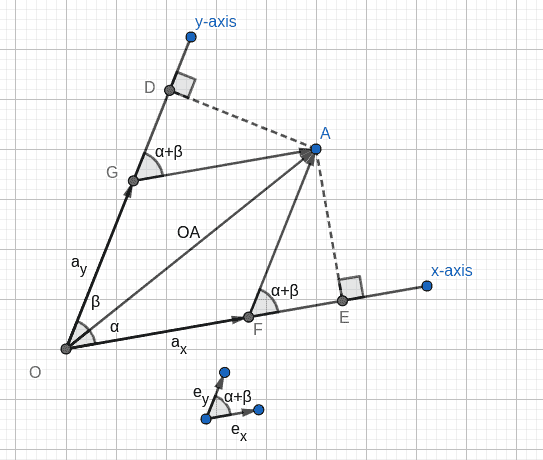

Thank you, @etotheipi for nudging me in the right direction (it's vectors, after all)!
I did not know about Basis. I think I now understand that. However, to not get ahead of myself, I redrew the figure as you suggested:
Then, I figured that following holds:
a_x = A\cos\alpha-a_y\cos(\alpha+\beta)
a_y = A\cos\beta-a_x\cos(\alpha+\beta)
where, ##A, a_x, a_y## are magnitudes of the vector, its ##x-##component, and its ##y-##component respectively, and ##\hat{e_x}, \hat{e_y}## are the unit vectors along the axes of the coordinate system of our choice.
Algebraically, these two linear equations can be solved to find ##a_x, a_y##.
Geometrically, it can be easily done by completing the parallelogram, of course.
Yes, nice! Your diagram and parallelogram constructions are perfect, and your equations look correct. I'll explain the more general theory, to show how to deal with non-orthogonal bases more easily. There's going to be a few new concepts here, so keep your wits about you... :wink:

Thank you, @etotheipi (is that the same as ##-1##? :wink:) and @vanhees71 for your encouragement, thoroughness, and kindness. Whereas I will take some time to understand the theory better, I felt that my question was greeted with compassion. Such human values are as important as the physical science itself.
I have derived the necessary equations based on a more elementary treatment as dictated by French's book. If you have time and interest, please take a look at my notes (page 40).
