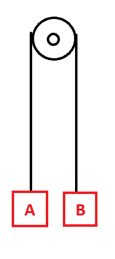

Pulley balancing question
This is a basic conceptual question. Consider having a pulley mounted with identical mass of block A and B. If i pull the block A slightly by say 10mm, and then release it. Will these weights try to balance itself due to potential energy difference or will be in the same state?
Diagram of an ideal pulley with a string hanging over it, a box labelled A on the left side and a box labelled B on the right side, both at the same height.
Say the rope has zero mass, total potential energy is constant during the process. If you pull 10 mm or with any other length, keep them at rest with your hand and release your hold, they balance there. If we cannot have zero mass rope, the downer side would go down more.
Pull the block how? Sideways like a pendulum and release from rest or pull it down? If pull it down, release while the block is moving or stop the blocks and then release?

Im pulling it down by 10mm, after small rest im releasing it again.
anuttarasammyak said:
Say the rope has zero mass, total potential energy is constant during the process. If you pull 10 mm or with any other length and keep them at rest, they balance there. If we cannot have zero mass rope, the downer side would go down more.
Thank you for the explanation! Say there is friction also in the pulley. That will also affect this imbalance right?
You refer friction. Both friction between rope and pulley and friction of pulley to rotate would matter.

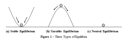

Lnewqban said:
I believe that self-balancing and potential energy difference are not related, at least in this case.
Self-balancing (stable equilibrium) happens around a local minimum of the total potential energy, for the whole system within which potential energy can be transferred (here both weights & rope).
In this case you don't have such a local minimum:
- For a mass-less rope it is a neutral equilibrium.
- For a massive rope it is an unstable equilibrium.

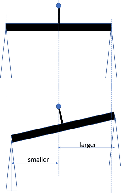

Thank you for the reply. In case of weighing balance, i guess its because of horizontal bar which is connected to the weights on either side. And when one side is pulled due to the net torque difference it balances itself. Am i correct?
But in the case of pulley, there is no net torque regardless position, so the weights stay put if the net force and net torque are zero. But technically the rope mass on downer side will be high. So due to net force value the weight should come down but its compensated by the rope friction with pulley? Correct me if im wrong. Thank you again!
Not exactly.
That case is like case (a) shown in Figure 1 of post #9: stable equilibrium.
But we could simplify the pulley-masses system to be seen as a "horizontal bar which is connected to the weights on either side" (the bar being the diameter of the pulley).
However, our pulley behaves like case (c) above: neutral equilibrium.
The net torque in each case is what makes the difference.
We have one torque in case (a), but none in case (c).
Case (a): The weighting device has the pivot point purposely located a little above the imaginary straight line that joints the centers of masses of both blocks.
Case (b): The pulley has the pivot point located exactly in line with the imaginary straight line that joints the points at which the strings supporting the blocks are tangent to it.
