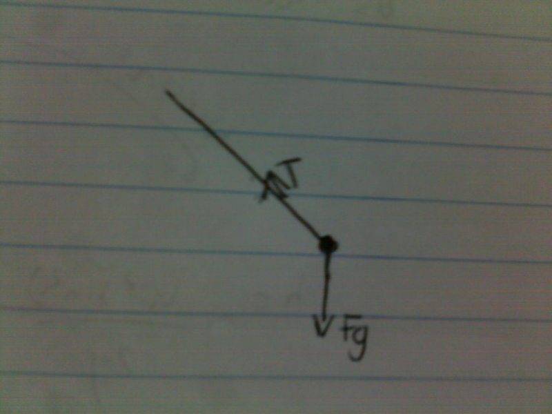

Why don't you start drawing a picture of the situation. And work it around to a free body diagram of the ball.
The equation is in vector form
There is tension and gravity
Yes. Please make the sketch.
  • FBD
That's a start. There is a bit more information: 36.9##^\circ##, 1.5 m and ##\vec a = -22.5 \,\hat\imath + 20.2\, \hat\jmath ## m/s2. (In fact I find these values a bit strange: I would expect a negative vertical component. Brings me to the question: what are ##\hat\imath## and ## \hat\jmath## ? I don't see them in the drawing).
Now you need a relevant equation to link the forces and the acceleration. Any idea ?
F= ma
The tension is causing the centripetal acc
So the centripetal acc will be in direction of tension and towards the center

Correct. It is a given that the ball describes a circular trajectory. Not with a constant speed (why not?).
Now it's time for another equation. And perhaps you can already draw the figure that part (a) asks for ?

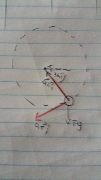

Is this ok
Ab17 said:
A ball swings counterclockwise in a vertical circle at
the end of a rope 1.50 m long. When the ball is 36.9° past the lowest point on its way up
I'm not good at approval stamping. But I am good at asking nasty questions, so:
  • What makes you think the ##\hat \imath## and ##\hat \jmath## are radial and tangential and not simply horizontal and vertical ?
  • Where is that 36.9° angle sitting ?
Because If a is the total acceleration then its components have to be I and J
Agree. But this goes for horizontal and vertical just as well.
Ab17 said:
36.9 is below the x axis
It cleary says something else altogether.
It tells us the location of the ball isnt
to me means the angle between the negative vertical axis (the ##\ -\bf \hat\jmath\ ## direction) is 36.9° .
So the complement of the angle you draw.
