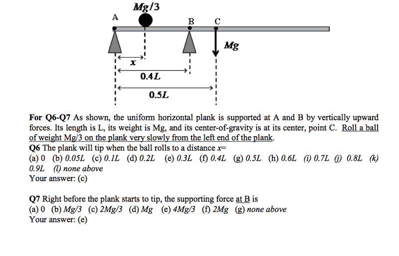

Hello, I am new to the forum and am in the process of studying for a test that I have tomorrow. The attachment that I have included is a screenshot of a quiz we have taken with the answers included already, but I am not able to figure out how the problem is done.
Any help would be appreciated since I have been trying to solve it for over an hour now.

What will be the reaction (normal) force at A when the plank just starts to tip? Use the equilibrium equations, please post your attempt and relevant equations for further assistance (per Forum rules), and Welcome to Physics Forums!:smile:

0-Mg/3(x)+ Mg(.4)(pivotb) -Mg(.5)(center of gravity)= 0...when I solve for x I get .3, but the answer is .1

Don't forget sum of Fy =0

What is the reaction force at B? It is not Mg.
That's what I seem to be having an issue with. Any idea? I'm assuming it's just Force * R(distance). The force in this case I assumed was Mg. What would it be?
Try summing forces in the vertical y direction. You know the given downward loads, and once you know what the reaction at A is, you can find the reaction at B. So, again, what must be the reaction at A when the plank is just starting to tip over and rotate about B? Hint: When it starts to tip, it loses contact with the support at A.
Wouldn't the reaction force just be 0 since there is no contact? How do I go about finding B?
After thinking about it for a while, I figured it out.
Solution question 6:
When the plank starts to pivot, it will pivot about point B. A can be neglected since it will not be in contact. Treating B as the center and the ball as the weight to the left and the center of gravity as the weight to the right, I got the following equation:
The ball will be -.4+x away from the ball and the center of gravity is at .5-
.4=.1
-Mg/3 (-.4+x) -Mg(.1)=0
Solving for x gives .1L.
Question 7:
For this part I used the original lengths given. This is the equation obtained:
-Mg/3(.1) + (x)Mg(.4) - Mg(0.5)=0
When solving for the x, 4/3 is the correct answer which corresponds to 4Mg/3.
Thank you for all of the help that lead me to the answer.
That's correct. So now just sum forces in the vertical y direction. You have the weight of the plank, mg, and the weight of the ball, mg/3, acting down. The reaction at A is 0, so what must be the reaction at B, acting up?? Then solve for x by summing torques = 0 about any convenient point (it is simplest to sum torques about B, now that you know that the reaction at A is 0).

OK, you're ahead of me. In this equation, you are summing moments about A, in which case your equation should read
-Mg/3(.1) + (Rb)(.4) - Mg(0.5)=0, then Rb = 4mg/3

You should now check your work by looking at forces in the y direction =0. Since you have mg + mg/3 = 4mg/3 acting down. you must have Rb = 4mg/3 acting up, which agrees with your answer. Good work.
