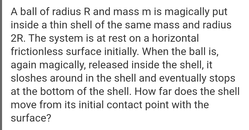

I found a very similar problem which also states that the horizontal floor is frictionless.
Yes, it's probably just an omission in the problem statement in post #1. If the shell doesn't slip either then it's just a kinematic question.
I note that the version in post #7 differs in two other ways: it does not specify rolling contact between the balls, and the ball comes to rest.
