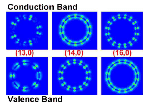

Hi,there are many literatures concered with band decomposed charge density(As an example,see FIG.3 in PHYSICAL REVIEW B 78, 235430 2008).
For condution band,there should not be charges or electrons when the system is in the ground state,but,those literares still show a band decomposed charge density picture,I'm very confused with that.

And the FiG.3 is shown as follows:
FIG. 3. Color online Band decomposed charge density at the Gamma
point for 13,0, 14,0, and 16,0.
In general, the conduction band isn't empty, not even in the ground state, especially in metals. So I don't see a reason as why not to calculate charge density. The pictures you are showing is the electron density $$ |\psi|^2$$ as would result from a single Bloch function or orbital being filled. Obviously, you can plot it irrespective of whether the orbital is filled or not.
