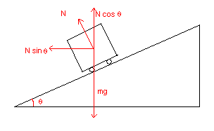

A road is to be banked so that any vehicle can take the bend at a speed of 30 ms^-1 without having to rely on sideways friction. The radius of the curvature of the road is 12m. At what angle should it be banked?
various inclined slope equations...
I got
[tex]N\cos\theta = mg[/tex],
[tex]N\sin\theta = \frac{mv^2}{r}[/tex],
so
[tex]\tan\theta = \frac{v^2}{gr}[/tex]
[tex]\therefore \theta = 82.4^{\circ}[/tex]
BUT, I have a question about this:
From a simple inclined slope, we have [tex]N = mg\cos\theta[/tex]
So, [tex]mg\cos\theta\sin\theta = \frac{mv^2}{r}[/tex]
But subbing in [tex]\theta = 82.4^{\circ}[/tex] now doesn't work! How come??
The free body diagram of a body moving on a road banked at certain angle [tex]\theta[/tex] can be drawn as in the attachment.
In the attachment, consider the following things:
N-->Normal reaction exerted by the surface (perpendicularly) on the moving vehicle
mg--> weight of the body, acting downwards
[tex]N~cos\theta,~N~sin\theta[/tex]--> components of N
As you can see, the downward force, i.e the weight of the body is balanced by the cos component of N (Normal Reaction), and thus it is,
[tex]N~cos\theta~=~mg[/tex]
Also the centripetal force required by the vehicle to move in a circular orbit is provided by the sin component of N,
[tex]N~sin\theta~=~mv^2/r[/tex]
Now that you know this, let me add, if you resolve 'mg', you'll certainly realize...
