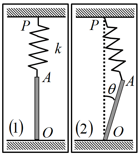

A bar with length [itex]l[/itex] and homogeneous mass distribution (mass: [itex]m[/itex]) can rotate around its fixed point [itex]O[/itex].The other edge of the bar is connected to the spring in the figure of constant [itex]k[/itex] and length [itex]l[/itex], and the spring is fixed by its one edge at point [itex]P[/itex]. The system is in the homogeneous gravitational field of the Earth.
i)find the positions of equilibrium (stable and unstable)
ii)show that for a small [itex]\widehat{\theta}[/itex] the motion that will result is approximately harmonic oscillation.
[itex]kl = mg[/itex]
First of all, the only equilibrium must be the stable one with θ=0rad since kl=mg.

What about ##\theta = 180^\circ##? Is that equilibrium?
Regarding the messy trigonometry, it is OK. Do that, and then simplify on the assumption that the angle is small.

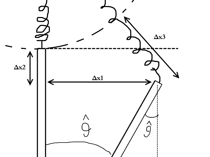

Okay I found what was wrong with the Δx=0 equation. But now I'm at this:
Hand-drawn diagram of a vertical bar hinged at its base with a spring attached at the top, tilted by angle θ, showing displacements Δx1, Δx2 and Δx3 and a dashed arc.
##Δx_{1} = lsinθ ##
##Δx_2 = l-lcosθ ##
pythagorean theorem:
##Δx_{1}^{2} + (l+Δx_{2})^{2}=(l+Δx_{3})^{2}##
solve for Δx3:
##Δx_{3} = \sqrt{l^{2}sin^{2}θ+(l+l-lcosθ)^{2}} - l##
##Δx_{3} = l^{4}\sqrt{sin^{2}θ + (2-cosθ)^{2}} - l##
for small ##θ##s:
##Δx_{3} = l^{4}\sqrt{0 + (2-1)^{2}} -l##
##Δx_{3} = l^{4}\sqrt{1}-l=l^{4}-l##
The result can't be that big for really small ##θ##s.
Diagram of a bar hinged at its top end to a vertical support, with the bar tilted at angle theta and two springs attached; dashed arc and horizontal dashed line mark the equilibrium position, with displacements labeled Δx1, Δx2 and Δx3.
##Δx_{1} = lsinθ ##
##Δx_2 = l-lcosθ ##
solve for Δx3:
Why is that ##l^4##?
for small ##θ##s:
If you fix the ##l^4## problem, that would result in zero. Which would in turn mean that your approximation is very coarse. For small angles, we replace the cosine with 1 like you did, but we replace the sine with its argument, not zero.
Yes but if ##θ## is infinitesimally small, wouldn't ##θ^{2}## be even smaller, so negligible?
Αlso about the ##l^4##, I'm really absent-minded and sleepless, forgive me.
Yes, you right about that. Here is another thing to. Expand the square under the radical, you will get ## \sqrt {5 - 4 \cos \theta } ##. Find the Taylor expansion of this, and retain only the terms up to and including ##\theta^1##.
Actually, wait. This is just the elongation, leave it as it is. Find the torque, then simplify.

Well that is puzzling... I end up with a ##θ## in the restoring force and not a displacement in length units.
The Taylor series for ##\sqrt{5-4cosθ}## is ##1+θ^2-...##
so that would make ##Δx_3=l(1+\frac{θ^2}{2}-1)=l\frac{θ^2}{2}##
and the restoring force ##F=-kΔx_3=-kl\frac{θ^2}{2}##
As I said, do not expand ##\Delta x_3## just yet. What you need here is the torque exerted on the bar, which you can equate with the change of its angular momentum. Do not forget there is also gravity.
Well I have trouble finding the angle on which I have to project the restoring force to calculate the torque. Can I do this with the force and not torques?

You want to compute the torque by the extended spring on the bar. Let's introduce some useful notation. Let ##\vec l## be a constant vector of magnitude ##l##, pointing upward. Let ##\vec b## the vector from the support of the bar (O) pointing to its other end (A). The magnitude of ##\vec b## is ##|\vec b| = b = l## and is constant. Let ##\vec s## be the vector from the rocking end of the bar (A) to the attachment of the spring (P). So this vector gives the orientation and the length of the spring; its magnitude is ##s##. It is obvious that $$ 2 \vec l = \vec b + \vec s $$ Then, the force by the spring is given by $$ \vec F = k \frac {\vec s} s (s - l) = k \left(1 - \frac l s \right) \vec s $$ The torque is given by $$ \vec \tau = \vec b \times \vec F = k \left(1 - \frac l s \right) \vec b \times \vec s = k \left(1 - \frac l s \right) \left(2 \vec b \times \vec l - \vec b \times \vec b \right) = 2 k \left(1 - \frac l s \right) \vec b \times \vec l $$ The magnitude of ## \vec b \times \vec l ## is simply ## l^2 \sin \theta ##, so $$ \tau = 2kl^2 \left(1 - \frac l s \right) \sin \theta $$ The formula for ##s## was found previously under a different name, so you have the complete expression for the torque due to the spring, which you can then linearise.
