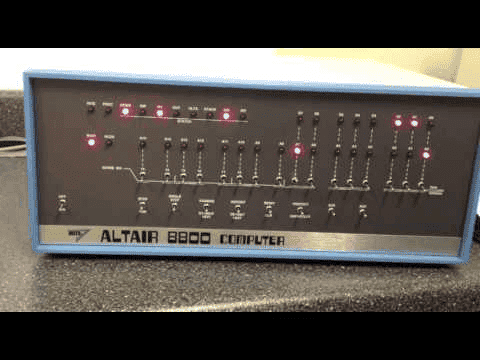

Well, Bare Metal programming started out meaning you were interacting directly with the hardware -- as in flipping front panel switches to enter a program.
At this level there was no operating system involved and no programming language. If you had a program stored on a peripheral that you wanted to load, you manually entered a program, in Binary, flipping switches, to read the peripheral and store each byte in memory. (I did that often enough that I had the loader program memorized, usually... every now and then it/I failed and had to get my wife to load it! That's how we both learned machine language programming.)
At some point Bare Metal programming morphed into any program you wrote that directly controlled some hardware.
Here is a photo from a 1975 computer that had only front panel switches for program entry. There were earlier 'professional' computers with similar front panels for a few thousand dollars, but this was the first one aimed at the general public, at a base price of a few hundred dollars.
I still have that computer, and after replacing all the electrolytic filter capacitors last year, it still works!
The row of 16 LEDs across the middle of the front panel indicate the memory address, in this case hex 0081 or octal 000201. The 8 LEDs on the upper right show the memory contents at that address, hex 06 or octal 006. The upper left LEDs show the state of the CPU and Control Bus Status lines.

I'm so ancient that I used the methods described by @Tom.G not just for the loader, but to enter and debug the entire application (a training simulator analogous to a flight simulator). Learning to read numerical results in binary with those lights was challenging. My predecessors did apps of similar complexity on a computer that had only 3 (24 bit) words of memory, plus a drum for bulk storage.
A company called Interdata in the 70s had the first hardware debugger. It was a knob labeled "SPEED". You could use the knob to slow down execution enough to watch the progress of your program instruction-by-instruction on those lights.
