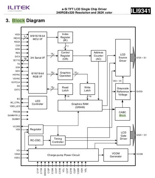

(I still don't understand how the controller really generates the voltages applied to the "source lines" of the grid... how the DAC generates that voltage exactly. But there's a lot in those datasheets actually. Also a block diagram...
Block diagram from the ILI9341 datasheet showing the chip's internal sections: MCU, serial and RGB interfaces, registers, graphics RAM, LCD source and gate drivers, power circuit and timing controller.
)Currently trying to figure out whether I should stick with the display above, or try to find one with a more popular ILI9341 controller (which is older than the ST7789 I think):
http://www.newhavendisplay.com/app_notes/ILI9341.pdf
Does anybody have a suggestion on ST7789 vs ILI9341?

@ST7789 vs ILI9341:
Some ILI9341 based products by newhaven were replaced by ST7789 based ones. So there might have some advantages..

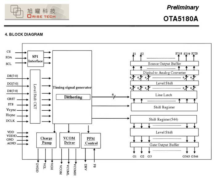

What also puzzels me about this topic: there's not much good info on the net about display technology (at least i couldn't find any yet), and all the cheap china displays on ebay or aliexpress have absolutely no info on pinout, dimensions, mostly no datasheet at all... - Do you know any place to find good ~320x240 displays for the use in microcontroller projects?
Some good answers for the initial question can be found in that white paper on Chip On Glass (COG) technology:
http://www.nxp.com/documents/white_paper/NXP_COG_WhitePaper.pdf
*reading it right now*
One of the best illustrations I've found so far on how a basic driver circuit/IC works is from that datasheet:
Block diagram of the OTA5180A driver IC showing SPI interface, timing signal generator with dithering, level shift circuits, charge pump, VCOM driver, PFM control, source output buffer, DAC, line latch, shift registers and gate output buffer driving outputs S1 to S720 and G1 to G544.
You seem to be on the right track looking at all the right stuff. Good finds/references. I don't really have anything to add.
