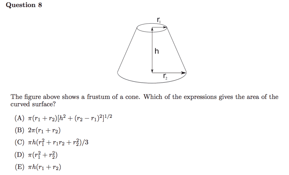

Homework Statement:: geometry
Relevant Equations:: literally geometry
I can guess this question, by seeing that the surface area of the curved part must be in the form pi r l.
Don't know how to get to this formula though.
Answer is AView attachment 267476
You have a choice of strategies. You could, of course, calculate the area of the given frustrum. Or, you could be lazy (or clever) and calculate the area of a cone and think about what happens when ...
`Everyone here is working too hard. Only two of the 5 choices have dimensions of area. Only one of the remaining choices has the area depending on h: i.e. the wrong choice says no matter how close or far apart the faces are, the area of the surface connecting them is the same. Sounds dubious.
And there you go.
Doesn't option E, ##\pi h (r_1 + r_2)##, also have dimensions of area and depend on ##h##?
Oops. You're right. I thought it was squared. However, it is possible to show this has the wrong limiting behavior.
Yeah, if we take ##h\rightarrow 0## without varying either of the radii, E would give that the curved surface goes to zero, whilst we know full well it will be an annulus :smile:

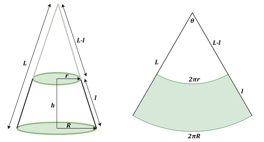

Another way to look at it:
How would you compute the slant height l, applying Pythagorean theorem?
So I presume if I do some long algebra with similarity proofs, I would end up cancelling terms and get it in the expression as they state?

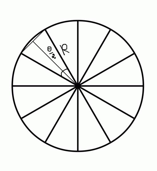

Imagine that that is a pyramid with ##n## faces of lateral height ##L=\sqrt{R^2+H^2}## (from radius and height). The area of a face, which is a triangle, is given by ##\frac12(2R\sin\frac{\theta}{2})L##.
To get the total lateral surface area of the whole pyramid, which is an approximation of the lateral surface area of a cone, we multiply the previous result by ##n## (because we have ##n## faces).
Since we have divided the circle into ##n## parts, we have ##\theta=2\pi/n##. We then get to the cone by taking ##n## to infinity.
$$S=\lim_{n\to\infty}nR\sin\left(\frac{\pi}{n}\right)L=\lim_{n\to\infty}nR\frac{\pi}{n}L=\pi RL$$
I have used the fact that ##\sin x## can be approximated by ##x## when ##x\to0##.
Do you understand the analysis that leads to the answer being A or E?
Note that ##B## has dimensions of length, not area, so it can't be that. And ##C## has dimensions of volume, so that's out. I wonder if ##C## actually gives the volume of the frustrum?
Option ##D## depends on ##r_1, r_2## but not on ##h##. You could have a very small ##h## (with a small area) or a large ##h## (with a large area), so the area must depend on ##h##. That's ##D## ruled out as well.
##E## looks good. You take the average circumference of the frustrum: ##2\pi(\frac{r_1 + r_2}{2})## and multiply it by the height.
##A## looks fairly complicated. It's not as nice as ##E##. But, how to decide between them? It would be much simpler if we had a cone!

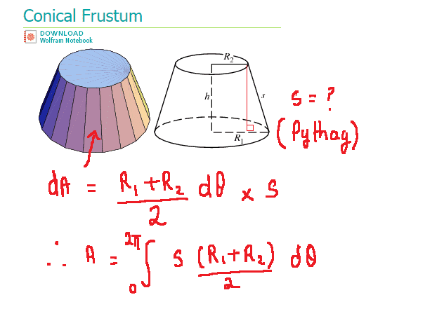

Here's yet another integral - I hope much simpler. I hear the post(s) re finding answer by elimination but the OP did indicate the answer was A and wanted to know how to get the formula.
This is essentially the theorem of Pappus 😁

Please, refer to figure of post #8 above.
As you could see if you unfold that surface over a flat plane, what really determines the area of the curved surface of that figure are the height ##l## and the two lengths (##2\pi~r_1##) and (##2\pi~r_2##).
Since answer (A) is in terms of given ##h## and not ##l##, applying the Pythagorean theorem to the formed right triangle, you can see that ##l## is the hypotenuse, that ##(r_2-r_1)## is one of the sides and that ##h## is the other side.
Because of that, we have:
##l=\sqrt{h^2+(r_2-r_1)^2}##
If we could consider the flat form as a "curved rectangle", we could say that:
Area of flat surface = Average length x ##l##
Being that average length a middle circular arc running equidistant from the external and internal arcs.
The equation for that middle circular arc would be:
##Average~length = (2\pi~r_1+2\pi~r_2)/2 = \pi~(r_1+r_2)##
Do those two terms have some resemblance to answer (A)?
Here's my tuppence ha'penny worth:
Consider the limit ##r_1 \rightarrow 0## and ##h \rightarrow 0##. We should get the area of a circle of radius ##r_2##. That must be ##A##.
