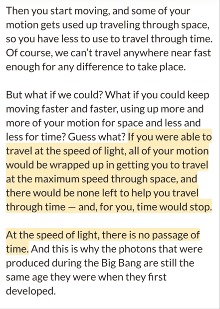

I’m not trying to be argumentative with you, but this excerpt is literally Microsoft Bing’s first hit on the subject, highlights are not mine.
Reply
  • Sad

davidjoe said:
I’m not trying to be argumentative with you, but this is excerpt is literally Microsoft Bing’s first hit on the subject, highlights are not mine.
I'm not trying to be argumentative with you either, but you should know that doing random Internet searches is not a good way to learn physics. You need to be learning from textbooks and peer-reviewed papers.
Bing is a search engine. It finds nonsense just as easily as good science. Actually, it is skewed towards bad science, since there is more of this on the internet, so its weighting ends up favoring bad science.
The above statements are a mixture of just wrong and totally meaningless.
Not everything you find on the internet is correct, and not everything correct is highly ranked by the search engines. In this case Bing is serving highly ranked incorrect content.
