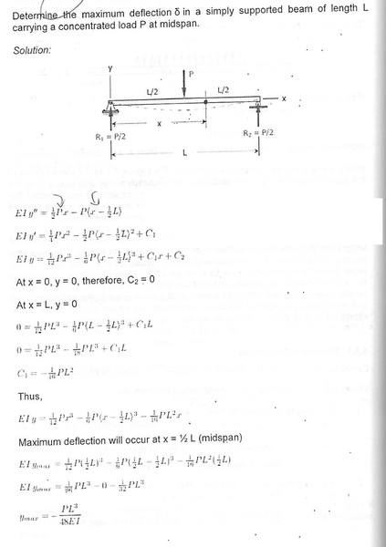

for the first line of solution , i don't undertsand why the author only include one P/2 force only...
Handwritten solution for maximum deflection of a simply supported beam of length L with a central point load P: diagram with R1 = P/2 and R2 = P/2 supports, and equations EIy'' = 1/2 Px - P(x - 1/2 L), leading to EIy = 1/12 Px^3 - 1/6 P(x - 1/2 L)^3 - 1/16 PL^2 x, and ymax = -PL^3/(48EI).
I think it should be EIy" = 0.5Px -P(x-0.5L) -0.5P(L-x) , am i right?

What definition of moment are you using?
Moment about point x
That is not a definition. see my reply to another of your questions
i am using the first one (algebraic sum of the moments on ONE SIDE of the section.
how does this question related to the question that i asked in another thread?
