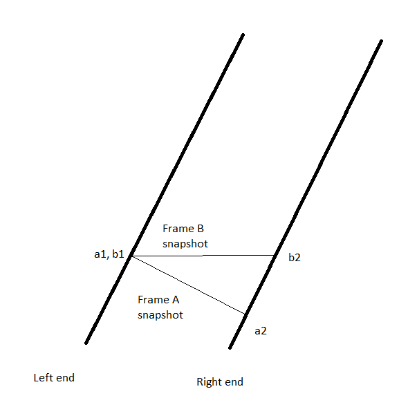

A meter stick is not a line segment the exists only as a snapshot in time. It has extent in time and is more like a parallelogram extending indefinitely into the past and into the future. When you measure its length, you are taking a snapshot at an instant in time according to some chosen frame.
When you measure the length of the stick in frame A, you are measuring from event a1 to event a2 such that a1 and a2 are simultaneous according to frame A.
When you measure the length of the stick in frame B, you are measuring from event b1 to event b2 such that b1 and b2 are simultaneous according to frame B.
Thanks a lot for this. Why is the meter stick longer in Frame B? Is Frame A traveling fast?

It is (edit: at least in some frames), just not at the same time. Thats what jbriggs444's diagram is showing you. Do you understand it? It's really the easiest way to resolve all relativistic weirdness.

  • #46
It would probably be better to reverse the frame nomenclature here. The natural way to interpret this diagram is that what you are calling frame A is Bob's frame (since that's the frame in which both worldlines, representing the two ends of Bob's meter stick, are at rest) and what you are calling frame B is Alice's frame.
  • #47
Per my post #46 just now, as @jbriggs444 has drawn the diagram, "Frame A" is really what you are calling Bob's frame, and the "Frame A snapshot" is Bob's meter stick at an instant of Bob's time. "Frame B" in the diagram is really what you are calling Alice's frame, and the "Frame B snapshot" is Bob's meter stick at an instant of Alice's time. Because the geometry of the diagram is actually hyperbolic rather than Euclidean, the length of the "Frame B snapshot" is actually shorter than the length of the "Frame A snapshot", corresponding to the fact that Alice sees Bob's meter stick length contracted. And the fact that the "Frame B snapshot" is at an angle to the "Frame A snapshot" corresponds to relativity of simultaneity.

I am sorry everyone; this is embarrassing. I just realized that this diagram is a description of my thought experiment. I understand now what is going on. Thanks a lot for this diagram.
