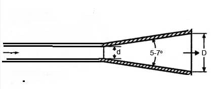

4) Water flows down the drain pipe at a velocity, and thus has a velocity pressure. A diverging section at the discharge end converts some of the velocity pressure back to static pressure, thus increasing the flow rate. Rough guess is discharge inside diameter about two times the pipe inside diameter is a good starting point.
See the diagram:
The angle is important, as is a smooth transition from straight to diverging.
