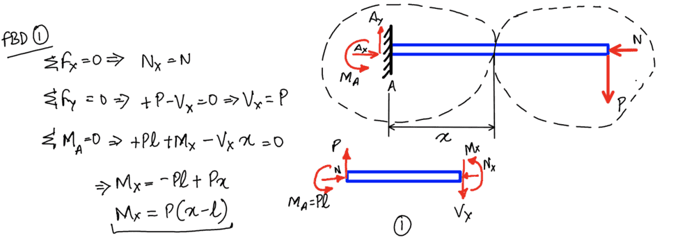

I was reading through a set of notes and found something a little odd. The aim is to solve the beam structure shown below, which is massless and of length ##l##.
By considering the beam as a whole, we obtain ##A_y = P##, ##A_x = N## and by taking moments about A we see ##M_A = Pl##.
However, now we consider a segment of the beam up to a distance ##x## along its length. We define the reaction forces and internal bending moments at this point to be ##N_x##, ##V_x## and ##M_x## as shown. The ##\sum F_x## and ##\sum F_y## parts are fine, but I wonder how they justify their third equation?

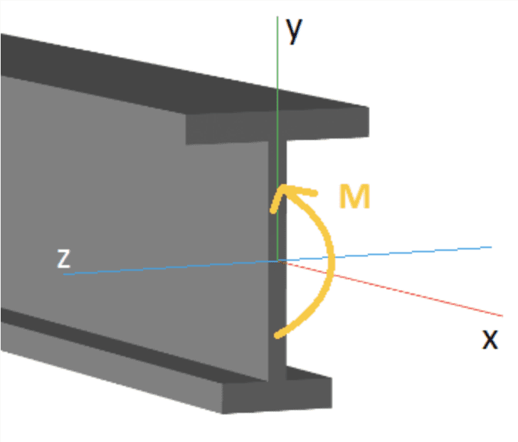

As far as I am aware, the internal bending moment at any point in the beam is taken about an axis passing through that point (N.B. we can really define 3 bending moments, but in this problem we only need the 1), like this:
##M_A## is taken about one axis, and ##M_x## is taken about another parallel axis displaced from the first axis by a distance ##x##. But when balancing torques, it only makes sense to add torques about the same axis!
I wondered then, why they used two torques about different axes in the same expression? Thanks!

I'm not sure I follow; I'm happy with considering a section of the beam and defining the internal forces at the cross section in the middle, I just don't see how the torque expression they give is valid. ##M_x## and ##M_A## are about different axes?
If we take moments about A, then the torque of the forces producing ##M_x## about an axis at ##x## will not be ##M_x## about an axis at A, since the lever arm of all of those forces have changed?

Right, sure, but ##M_x## is the torque about an axis passing through ##x## caused by uneven distribution of stress across a cross section at ##x##, whilst ##M_A## is the torque about an axis through ##A##.
They take moments about ##A##, but include ##M_x## in their expression. I would argue that the torque produced by the uneven distribution of stress at ##x## is not ##M_x## when taken about ##A##.

I wonder, are bending moments always caused by couples?
The moment of a couple is indeed invariant for all parallel axes, which would be a resolution.
I would venture to respond yes to your question.
"Pure moments" do not exist in nature, we always have a force and a lever involved in such abstract concept.
But it is a very useful concept, nevertheless.
What makes bending or flexing of members the worse scenario in most cases of resistance of material and structural problems is the huge ratio of internal forces to available lever distances compared to the external forces and dimensions (in other words, how many times is a beam long compared to its sectional height).
Ah, awesome, thank you @Lnewqban!
In that case for a prismatic member in pure bending, with bending moments on each side ##\vec{M}_A## and ##\vec{M}_B##, the total moment about ##A## is also ##\vec{M}_A + \vec{M}_B## since the moment of the couple producing ##\vec{M}_{B}## about ##B## is the same as about ##A##. I have the feeling that on any cross-section, the effect of the internal forces can always be decomposed into a normal forces and two shear forces, and at the same time can be decomposed into a couple of moment ##\vec{M}##.
