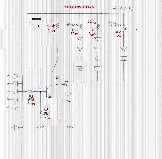

Here's an idea if you get printed circuit boards made. Lay it out so each board supports 1x 556, 2x pairs of transistors, and 10x LEDs. When soldering on the blue LEDs, you have one pair of transistors driving 6 LEDs and the other pair driving 4 LEDs. When soldering on yellow or red LEDs, use a few jumper links to drive all 10 LEDs from one pair of transistors, leaving the space for the second pair of transistors empty.
  • #62
Freddythunder said:
I ran a single LED to the 556 to check it's operation and it was working, but nothing was going through the transistors. So I don't think I burnt it out. I will try the new resistor values you suggest. Thanks.
Small signal transistors do get killed without much effort. It is easy to get their leads mixed up. Check that; otherwise, replace it and see whether the circuit starts working.
  • #63
I'll add a note for when you run your circuit off the car's electrical system...
Refer back to the circuit schematic, you'll see capacitor C1. It's there as representative of an attempt to filter potentially destructive spikes that may damage your semiconductors. I suggest that you make C1 using 3 capacitors in parallel to make it closer to ideal: 470uF, 10uF, 0.1uF all in parallel, rated at least 25VW.
If I were building this for myself, I'd use a more thorough filter than this, but as you are working to a tight budget, try those and hope for the best.

My suggestion for different capacitors in parallel is an attempt to produce behaviour closer to the ideal. While big capacitors (electrolytics) store a lot of charge, they are slow to react, and fast spikes can still get past them. Smaller capacitors are faster to react, so can better absorb fast spikes, but they can't absorb much energy. Placing a few different ones in parallel is a way to get a large capacitance which can still react fast.
I suggested that as a crude protection against transients on the vehicle power supply when the engine is running. If you power the display only while the engine is off, and is kept off, there should be no spikes in voltage.
There are regulator ICs available, or something could be constructed using a couple of transistors, but the circuit you built is probably sufficiently robust that the capacitors will do.

All blue LEDs (at 120 mA Each array) would pull 480mA
All red LEDs (at 60mA each) would pull 240mA
According to this:
http://www.555-timer-circuits.com/increasing-output-current.html
Can I use 1 BC337 for each of the colors off of two of the circuits? One 556 switches a 337 for the blues and the other 556/337 for the reds?

Your image seems to show 7 red LEDS in a series string, to be powered by the vehicle battery, nominally 12 volts. Each red LED has approx 2.1v across it, according to your earlier measurements, making a total of 14.7v not including what is required across the current-limiting resistor. I can't see this working. I certainly would not have offered this as a viable arrangement. You can have no idea whether it will work, or what the current will be. Definitely inviting trouble in my opinion.
And it's similar bad news for the blue LEDS if you were to string 4 in series here. :cry:
  • #75
My apologies - the reds are 6 and 4 not 7 and 3... The way I built the thing, the resistor was going in the opposite direction of where I was counting. As for the LEDs, they do all work. I've had 6 of the 8 segments all bliking at once and all segments currently work. I also had a blue one flashing for a few hours; figured if it's going to burn out or blow up, I'd see something then.

I wound up putting together two 556 circuits and connecting the output to a TIP31 transistor for 4 segments of LEDs each. The circuits are currently in a breadboard, but for the time being, I think it will probably stay like that. I finished wiring up the lightbar and ran about 6 feet of wire off the end so that I can connect it to anything later if I change my mind, solder circuits together, get printed circuit boards, box up the breadboard, or any other option.
