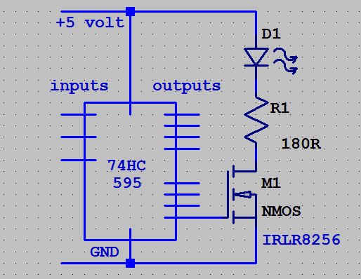

So I went around the "www" to search for some easy but working tricks and it seems I found a possible solution that uses the 74HC family IC but not the one you mentioned @pbuk but instead the 74HC 595
Please see this interesting approach in the video below , turn to 5:36 if you wish to see the schematic.
The interesting part is that the video author seems to use just a single 595 IC, and in order to drive the 32 LED's he puts them in pairs by 8 , each 8 LED's are connected in parallel but due to the layout as the shift register IC turns a few outputs OFF and changes that OFF position the actual OFF position within the circle happens at two places and moves around, smart isn't it?
What do you think?
PS. Is this anywhere close to what you meant @Baluncore by your parallel loading a shift register?

Not the same, and I don't think it does what you want.
I would use several shift registers to make a 32 bit register to drive the MOSFETs.
If I was using four 8 bit SIPO registers, I would use 74HC164 which is simpler and probably cheaper than the 74HC595. It could be initialised by an MCU.
Without an MCU, a PIPO shift register would be easier to load with a pattern.

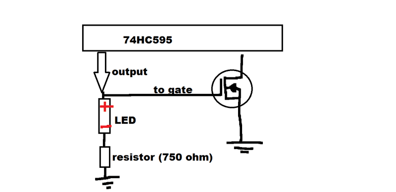

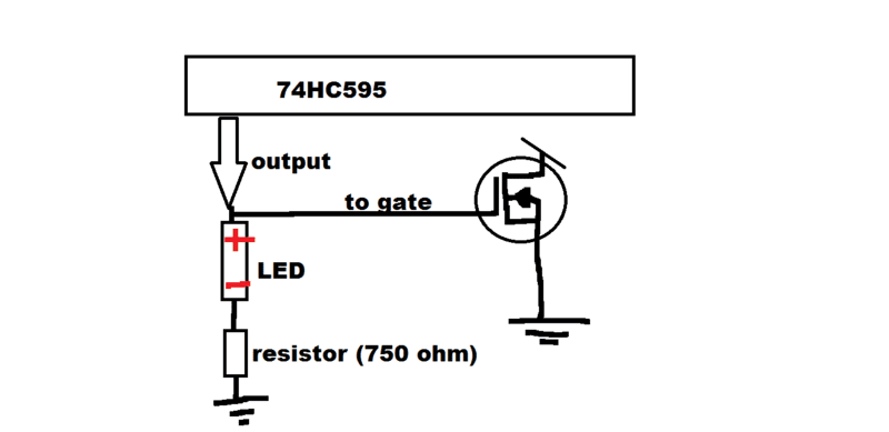

One more thing , I searched for the parts you mentioned in farnell since I will be shipping from there but sadly the N mos is out of production or at least not available, either way , what would be the typical needed gate voltage to reliably drive these small fets?
I'm just thinking of where to add the gate connection in the output of my shift register since I also plan to use the LED's for visual confirmation of the selected pattern.
I think the output will be like this - shift reg. IC - LED - resistor to ground. I could in theory put the gate connection after the LED so that it is between the LED and the current resistor to ground, given the resistor value there should be about 2 volts above ground or more.
Another option is to put the gate directly to the shift reg IC output, between the LED and the IC. But then I would probably need a resistor directly to ground as I doubt the gate would discharge reliable through the LED given it's voltage drop.

Their gates switch between zero and 2.5 volts. But you need to look at the region with Isd = 10 mA, so you might get away with less.
You wrote that you did not want a LED chaser, but now you do.
Save power by lighting the minimum number of LEDs.

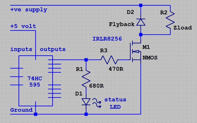

Well I currently went for a TLC555CP and 4x 74HC595 chips to get a combined output of 32.
the most complicated thing so far I've found to be the designing of a proper PCB and routing of the 4 shift register IC's , the 555 timer circuit is very simple and requires only few components.
I would need the 4 shift registers also if I used a MCU I think, after all they "expand" the few IO outputs to many more.
The thing that would be easier though is to control the sequence as @DaveE and others already said.
I'm designing a small Kicad PCB now, let's see how it goes for me, if anyone does care I might come back and post my results.
