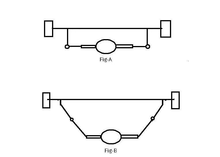

Since I train powerlifting I have started to get interested in the mechanical analysis of the different exercises. But the bench press I haven't been able to figure out. When I am considering a dumbbell bench press the mechanics seems simple, but when I consider a barbell bench press it becomes difficult. If you consider the situation with dumbbells, the torque at the shoulder is the force from the bar (F) times the horisontal distance between A and C. The same for the torque at the elbow which is the F times the horisontal distance between B and C. But when the hand is fixed to a barbell things get changed. So can someone please help me figure this out. If you could use the figure or make your one figure and explain the forces and torques involved i would appreciate it.

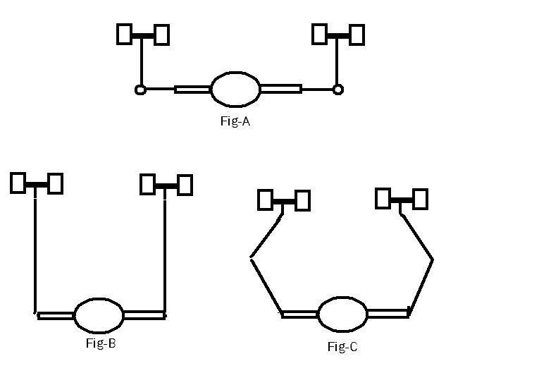

Hi this is a nice thread and I would like to participate in your discussion.
I have a strong doubt that during barbell bench press, the role of and the load on pectorals is much greater (at the same time lesser role of and load on triceps) than dumbbell bench press. I have been thinking to experiment on the same and get a right conclusion.
In Dumbbell bench press, both the dumbbells are allowed to contact each other during each push which enables humerus on both sides to adduct more and attain a vertical position before returning back to neutral (see Figure-A & B- first image) . In Barbell bench press, the distance between the hands remains constant hence scope for humerus to adduct is limited up to 60 degrees (approximately) from horizontal (see Figure-A & B – second image). In Dumbbell bench press, triceps must act concomitantly to extend the elbow, because during adduction of shoulders, the elbows can tend to flex and hands moving towards the chest (see figure-C- first image).
If we keep the load constant, Dumbbell bench press may demand more energy output from push muscles than barbell bench press. The reason for this is greater work done during dumbbell bench press due to greater distance traveled by the load from neutral position to end position.
