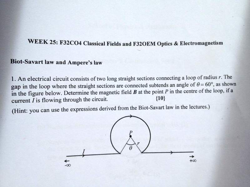

1. An electric circuit consists of two long straight sections connecting a loop of radius r. The gap in the loop where the straight sections are connected subtends an angle of theta=60d, as shown in this figure (http://imgur.com/tseDHL6). Determine the magnetic field B at the point P in the centre of the loop, if a current I is flowing through the circuit.
See the diagram here - http://imgur.com/tseDHL6
2. Biot-Savart Law
3. The Attempt at a Solution - http://imgur.com/QFrlSn7
I have found the equation relating to the full loop but don't know how to do it for the missing segment.

What's wrong with integrating ##d l\over r^2## ?
You need to use the Biot-Savart law:
Ma is right, but the next step is to convert to integrating ##d l\over r^2## because there is only one component left over; the others cancel.
\int rd θ/r^2/
Consider finding the field as though the circular section wasn't there, but the wire was continuous from -infinity to +infinity: B1. Can use ampere's law.
Then, use Biot-Savart to compute the field due to a short section of wire connecting the loose ends of the loop: B2.
Then, use Biot-Savart to compute the field due to the loop: B3.
B = B1 - B2 + B3.
