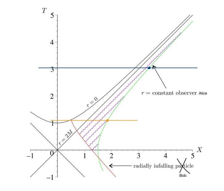

Hello everyone!:) This is my first post on here. I'm having trouble understanding what is real for Alice. I looked at different physics websites and there seem to be only a few questions addressing this some of which I don't understand. I thought maybe I'll get some clarity here if I ask my own question or my question just doesn't make sense.
Maybe this isn't a physics question but a philosophical one or one looking for a possible philosophical interpretation of my described event?
Alice is an external observer far way. Bob is falling into the black hole. Alice decided to use the Kruskal-Szekeres coordinate system to map the spacetime manifold. In that coordinate system the coordinate Kruskal time doesn't approach infinity for someone crossing the horizon and even after crossing it. So the Kruskal time is a finite value. Alice synchronizes her clock to the kruskal time which is also her proper time since she is far way.
Alice now takes a look at her clock. Then she looks at Bob falling into the black hole. She starts assigning some coordinate time to events she can see. She won't ever see him cross the EH because it'd take an infinite amount of time to observe it. BUT did that crossing happen in Alice's reality even tho she can't see it? Alice and Bob are in the same spacetime coordinates that describe that same manifold which is the same reality they both are part of? And looking at that global manifold we see it happens.
So is it true that there is some finite coordinate time value for Alice on her clock where Bob is in the black hole but that coordinate time could be any time since she can't ever see him cross and assign a time? But at the same time there has to be some unknown coordinate time because both are part of the same manifold that i.e. the same reality.
As far as my understanding is Alice herself can't assign a coordinate time to that event because in order to be able to do so she'd need to observe it and then look at her clock? It'd take an infinite amount of time for Alice to see it but it shouldn't take an infinite amount for Alice for it to actually happen but without Alice seeing it. But since the coordinates used have a finite Kruskal time there has to be a consensus that it happened for the outside observer as well in finite Kruskal time but the observer just doesn't know when. Alice synced her clock and it takes a finite kruskal time to cross so it'd be right for the outside observer to claim it happened at any of that finite time?

I found this picture online. If you look at it you see spacetime described by kruskal coordinates. There's a blue horizontal line and an orange horizontal line. Both lines have an intersection with the green line marked by a dot in the corresponding color. Here we see that the blue dot is at around kruskal time 3 and the orange dot at around kruskal time 1. The green line is an external observer. It can be Alice but we said she's very far away which isn't properly represented here. The red line is Bob.
We see Bob merges with the singularity at around kruskal time 1 and I can draw a horizontal line in this global coordinate system which I assume is the global reality I'm talking about. That line shows Alice existing at a kruskal time 3 that is after the time according to that global manifold where Bob ended up in the singularity. It looks like Alice exists but Bob doesn't anymore at this coordinate time which Alice cannot assign or be aware of because she has no way of knowing it but the universe appears to know it as evident on here.
Isn't this what we see here? Can Alice therefore mention any coordinate time and there is a chance that it is true but she won't ever know if its true because the event is covered by an event horizon?

Yes exactly. I'm talking about the region outside that as well. That'd mean they're spacelike separated but nevertheless they're still part of the same spacetime manifold. That region outside that is also the reality I'm referring to. Even though they're space like separated they're part of the same universe.

What does this mean? What is the interpretation of this? What can Alice say about Bob now? I think that's what I'm asking about. As Bob crosses the horizon and Alice continues on her worldline outside the horizon the kruskal time keeps increasing. The whole universe which is everything in the diagram goes forward in time as this kruskal time increases and according to the coordinates both Alice and Bob increase in their kruskal time and their temporal evolution or however you want to call it keeps going on and they both keep following their worldines. Doesn't this mean there has to be a kruskal coordinate time for Alice that Alice is not aware of at which Bob is below the event horizon? Although it would be impossible to know for her. At some point "the universe" due to temporal evolution is going to "place" them such as Bob is annihilated and Alice is outside somewhere. The universe has to do it because there's just no other way around. Alice and Bob have to be somehow placed in this manifold. Haha okay does this make sense 😅
This probably describes the best what I mean by "reality".

Now an important fact appears that I could draw the Kruskal-Szekeres coordinate system in such a way that in one Alice would be placed at the same kruskal time value as Bob when Bob hits the singularity and I could draw it differently such that Bob hits the singularity at some Kruskal time but Alice is at some greater Kruskal time then?
Nugatory said:
That can tempt us into thinking that the time coordinates of events off that worldline have some special significance to Alice. They don’t.
And because I could draw two different Kruskal-Szekeres coordinate systems like I described above the coordinate time has not much significance to Alice even though she synched her proper time to this coordinate time. Because I could just draw it a different way and Alice could assume that now at this coordinate time which is her proper time Bob met the singularity but she could also say he didn't. And neither statement would be valid nor wrong. She can say anything. And this arises due to spacelike separation caused by the event horizon.
There are mathematical difficulties here because "Bob hits the singularity" is not an event. However, "Bob crosses the event horizon" is an event and raises all the same issues, so let's consider that instead.
If Alice-one and Alice-two are using the same coordinate system to label events they will of course attach the same time and space coordinates to all events, including Bob crossing the horizon. However, the time coordinate assigned to the event "This point on Alice-one/two's worldline" may not be equal to the time displayed by their clock at that event.
The event horizon doesn't cause spacelike separation. Events on the same side of the horizon may be spacelike separated or not. The event horizon does mean that the future light cone of events at and inside the horizon will not include any region of spacetime outside the horizon.
You're getting yourself confused here. If you're using Kruskal coordinates, Kruskal time defines "when" things happen according to those coordinates. Once you've picked out some event on Bob's worldline, whether it's the event where he crosses the horizon or the event where he hits the singularity (defined as a limit point per my statements above), there will be some event on Alice's worldline that has that same Kruskal coordinate time. Asking whether that event is "where Alice is when Bob experiences event X" is pointless; you've defined "where Alice is" by picking the coordinates.
Of course coordinates have no physical meaning, and there's no actual observable that tells you "where Alice is" when something particular happens to Bob at a spacelike separated event. But that doesn't mean there is some other "true" answer to "where Alice is" that's different from the answer Kruskal coordinates (or whatever coordinates you've chosen) give you. It means there is no "true" answer at all; asking "where Alice is" when something particular happens to Bob is a meaningless question. Only questions involving invariants--things that are independent of the coordinates you choose--are meaningful questions.
For example, you could pick some event on Alice's worldline and ask, can Alice send a light signal to Bob from that event, that will reach Bob before he hits the singularity (or crosses the horizon)? That question has an invariant answer (and the Kruskal diagram makes it easier to find it because light signals travel on 45 degree lines, so it's easy to see where the light cone boundaries are).
