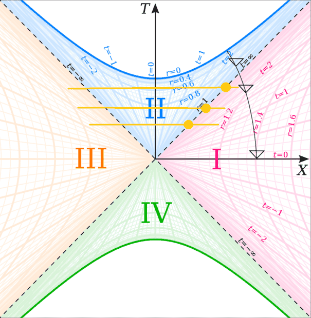

What you are saying can be seen in the Kruskal diagram (courtesy of Wikipedia: Kruskal-Szekeres coordinates), right?
The dashed line represents the horizon ##r=r_H##, and that is a null line which of course is generated by a null generator. In the Kruskal diagram, the angular coordinates are suppressed so that each point/dot on the diagram represents a 2-sphere. Therefore, each yellow dot represents a 2-sphere of which the event horizon is composed of. This is what you're saying that the event horizon is an infinite, continuous series of 2-spheres parameterized by a null generator.
Knowing this, let's suppose I can draw a yellow line across the diagram to represent a spacelike surface (pardon the inaccuracy of the yellow line but I know you know what I'm saying, just wanted to point out something on the horizon), it will intersect the horizon at the yellow point. This is what you're saying that different spacelike surfaces can intersect the horizon in different 2-spheres (different yellow dots).
Correct me if I'm wrong here.

No, I'm saying you are misunderstanding the paper. The paper, or at least what you quoted from it, does not say the event horizon as a whole is 2-dimensional. It only says that the intersection of the event horizon with "space at an instant of time" is 2-dimensional.
Yes. Your description of this is correct. Note, though, that the Kruskal spacelike surfaces are not the only possible set of spacelike surfaces you could use.
