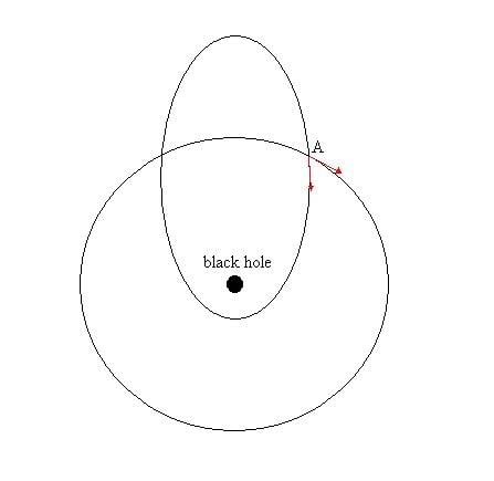

I believe I have refined my question.
For now, I only need to talk about one black hole and its effect on objects passing near it.
Consider the following diagram:
What we have is a black hole with two objects of negligible mass (clocks) orbiting it. Let's say both objects pass point A at the same time--and, at this instant, they have identical speed (obviously not identical velocity). The orbit of clock 1 takes it in a circular path, while the orbit of clock 2 takes it perilously close to the black hole--as close as it can go without being torn apart by tidal forces.
Now, we wait for the two clocks to make a complete orbit and end up back at point A.
Here are three "possible" outcomes:
1) The two clocks both make a complete orbit and arrive at point A at the same time. We read the clocks, and they show identical times. This is what we would expect if we were only considering Newtonian gravity and no effects of relativity.
2) The two clocks both make a complete orbit and arrive at point A at the same time. We read the clocks, and clock 2 is slightly late. This is of course due to the time dilation it experienced while near to the black hole...but the time dilation did not affect the time it took to orbit the black hole.
3) The two clocks both make a complete orbit, but clock 2 arrives at point A after clock 1 has already passed it. Both clocks showed the same time when they passed point A, but clock 2 is obviously late--it should have been showing that time earlier, when clock 1 was passing point A.
I'm pretty sure outcome #1 wouldn't happen in real life, since we know gravity isn't purely Newtonian. My question is, would outcome #2 or outcome #3 be the result if this experiment were carried out in real life?
