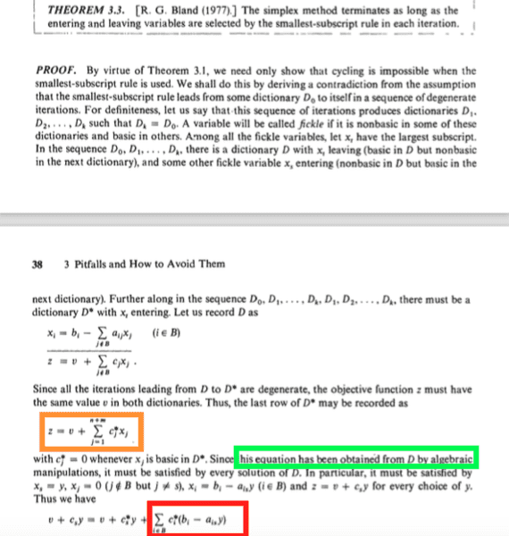

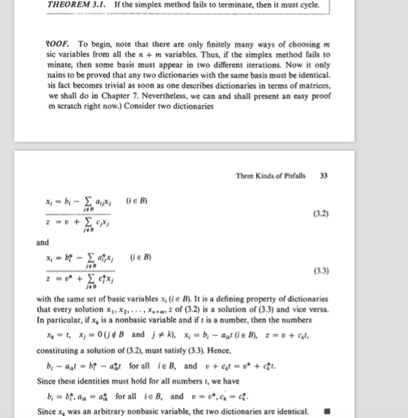

The presentation of Bland's rule proof you gave in your link is mostly the same as the one on pages 37--38 of the book "Linear Programming", by Vasek Chvatal, but with some aspects missing.
First, the actual Bland rule involves using the smallest subscript rule for both entering and leaving variables, but your attachment talks about entering variables only; however, maybe in the lectures this was discussed more fully.
Next, your attachment has variable ##x_t## leaving in some dictionary D but entering again in some other dictionary D*, and for that to happen we may need more than one "cycle". That is, we might not have ##x_t## leave and then re-enter in the sequence of dictionaries ##D_0, D_1, \ldots D_k = D_0##. For example, ##x_t## may be non-basic in ##D_0##, then enter at some ##D_p## then leave again at some ##D_q > D_p##, never to enter again before ##D_k##. The cited document does not account for such a case.
The argument of Chvatal gets around this potential problem by noting that if we always apply the same rules and get cycling, then the extended sequence ##D_0, D_1, \ldots, D_k (= D_0) , D_1, D_2, \ldots## will always be obtained and it will always contain a subsequence in which ##x_t## leaves in one ##D## and enters again in some later ##D*##. Then the arguments given in your cited document go through, and are essentially a copy of the arguments given by Chvatal.
Finally, I will say that if you Google the keywords "Bland's rule" you will see many different proofs of the rule. If you are having trouble following one proof, nothing is stopping you from going on-line to look at other proofs.

I think you should first do the simplex pivots with ##x_s=0##. Then start again with ##x_s=q## to see how things change.
tnich said:
I suggest that you follow the author's plan: write out a tableau with a degenerate solution, pivot to bring one of the fickle variables ##x_s## into the basis, set ##x_s=q##, and then perform a pivot to bring a new fickle variable into the basis. See what you get. Then compare your result with ##\upsilon+c_sq = \upsilon+c^*_sq + \sum_{x_k \in B_i} c^*_k\left(b_k-a_{ks}q\right)##.
Initially, thanks for your attention, not being relentless...I have been suffocating in that problem for 2 months, I strived for digging something valuable out of internet but I encountered the same proof related to Bland rule( I bet you can not find different kind of proof about that either, ALL PROOFS ARE SAME believe me ), so I decided to discuss my problem with you, did not created a thread as soon as I had a problem, also I already have the Chavatal book by the way I will present the CONTRADICTION about the proof even in Chavatal, thus I would like to share 2 different screenshot from Chavatal:
In the picture 1 he updates the non basic variable ##x_s## with a some number "t" and according to new value of ##x_s## he also updates 2 different dictionaries. I totally agree what he did in picture 1.
BUT IN PICTURE 2, he again updates the non basic variable ##x_s## with a some number y ( it was "t" in picture 1, nothing different ), while everything is going as I want then he adds the equation in the RED BOX which is ## \sum_{i\in B} c^*_i\left(b_i-a_{is}y\right)##. Why he adds RED BOX??
He also expresses in GREEN BOX that the equation in ORANGE BOX which is ##z = \upsilon+ \sum_{j=1} c^*_jx_j## obtained from algebraic MANIPULATIONS. WHAT is this ALGEBRAIC MANIPULATION??

Once again, I suggest that you mechanically work through the pivots and see what you get.
