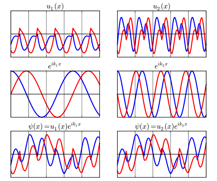

If you see this picture of a bloch wavefunction, you see that it has two types of periodicities involved, one with the lattice constant(the bloch part), but what is the periodicity of the enveloppe.

http://upload.wikimedia.org/wikipedia/commons/5/56/BlochWaves1D.svg
I don't get this.
a bloch function is like
On the picture, u see that psi(r) and the exponential term and the u(r) term all have different period.
But bloch theorem states that
psi(r+ lattice vector) = psi(r)
and
u(r + same lattice vector) = u(r)How can this all be if they all have a different period?IF the exponential term corresponds to a free electron plane wave AND the periodic u-term corresponds to the lattice (it repeats itself between the ion-sites), how can Psi (the bloch wavefunction) has the same period as the u-term, as the lattice since it is getting modulated by the exponential term.
Clearly the Bloch wave hasn't the same period as the lattice. :(:(:(
The wavelength of the bloch wave is at least 5*a as u can see above ...
I don't get it!

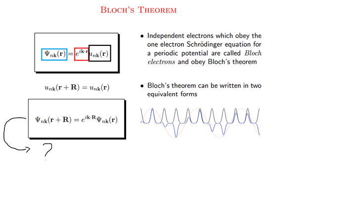

That's not correct. Only the expectation values have to be invariant under translations by a lattice vector. Hence the wavefunction can get multiplied by a phase factor, namely, ## \psi(r+R)=\exp(ikR) \psi(r)##.
Wow, I still don't get Bloch's Theorem.
I thought I knew it, but the second form always confuses me.
The probability density is the same, because the absolute factor of the phase turns 1.
I just don't see where the probability density's are the same. If you would square the blue part, the Bloch wave, then the probability density should be the same at distances separated by R right? And R has the same periodicity as the lattice potential, so the probability density function should have the same periodicity as the lattice?
I just don't get the second form.
|## \psi(r+R)| ² = ## \|psi(r)|² The phase factor in absolute value squared is 1, so why is the probability density function (if you would square the blue part) not periodic with the black part (the lattice) It's both the same with R!Sorry for bump, I just never seem to grasp Bloch. And if I think I understand, a year later or more or less, I seem to have forgotten it completely.
What does exp(ikR) really do visually, which periodicity, what effect has it on psi(r)?

Is it because the blue part is only the real part?Another picture
If you would square the total Bloch wave (both real and imaginary part, not individually but the total (Abs(Real + Im)))^2 in the bottom would it then have the same periodicity as the top picture, the lattice? Because I've read somewhere that the probabilty to find the electron is the same at each lattice point. So while a Bloch wave be it the real or imaginary part doesn't have the same periodicity as the lattice, the square of the total Bloch wave does?
What does the phase factor do? Shift the Bloch wave with a value to the left?
What does the second form really implies? A Bloch wave is clearly periodic but with what value?
Real part of a bloch wave is not periodic with the lattice, but a bloch wave squared is.
Correct?
Correct.

I think a Bloch wave is not lattice periodic. If you plot real part or imaginary plot it's not lattice it's not periodic, but the complete Bloch squared, so the probability density of finding electron is lattice periodic.
Thats fine but, the wave function is crystal periodic, which is the same thing as give by the Born von Karman conditions. As expressed, the wavefunction has to obey from Bloch's theorem:
\psi_{k_{i}}(r+n_{i}a_{i}) = exp^{i.k_{i}n_{i}a_{i}} \psi_{k_{i}}(r)
Where ##k_{i}## goes from ##0## to ##2\pi (N_{i}-1)/N_{i}## due to the Born von Karman conditions and you should be able to choose ##N_{i}## arbitrarily (in my humble opinion).
If I choose ##N_{i}=1## then the only allowed ##k_{i}## is 0, which then makes the wavefunction lattice periodic by default because the lattice is the crystal here if i set ##n_{i}=1##. You can see
\psi_{0}(r+n_{i}a_{i}) = exp^{0} \psi_{0}(r)
Whats so beautiful is that if you increase ##N_{i}##, it hardly has any physical meaning because it doesn't effect the real configuration of the system, however, this now allows for solutions which are not necessarily lattice periodic but are necessarily only crystal periodic. My basic question here was that because I have demonstrated this for ##N_{i}=1## that the wavefunction has to be lattice periodic, shouldn't therefore there be at least one solution to the wavefunction which is lattice periodic?
