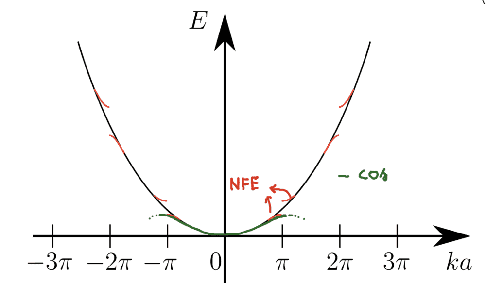

I think I solved my problems. If you don't mind I'll try to explain them so that you can tell me if there is something wrong.
1st problem: my obsession for the semiclassical model.
Answer: well, I'm a bit unsatisfied, but I read in Ashcroft's book that
(...) it is extremely difficult to justify.
It might be well above my current possibilities. It just works well in predicting the motion of electrons in between collisions so I must get over it and content myself with that.
2nd problem: free electron vs nearly free electron vs tight binding
Answer: They are different approximations and depends on the particular crystal I'm dealing with. If the attractive potential energy of the ions is very strong, tight binding method is the most appropriate, while, as ##V(r)## decreases, the other approximations could also do the job.
3rd problem: does tight binding wave function reduce to plane wave ?
(Partial) Answer: Here I don't know if the wave function should resemble the plane wave one in between two lattice point (ions) , or if the "global" shape (the envelope, as you said) should be a plane wave.
Let me first consider the energy spectrum as a function of ##k##:
In black you can see the free electron parabola, while in red the "corrections" applied by the nearly free electron model (from perturbation theory), and the green line is the behavior you'll get with the tight binding method (a cosine).
Here you can see that far from bragg planes the behavior of the tight binding method follows pretty well the free electron parabola. Also, when the potential is almost constant plane waves are the solutions of the Sch. eq.
fluidistic said:
Regarding your previous post, I'm sure you already took a look at this picture: https://en.wikipedia.org/wiki/Bloch_wave#/media/File:Bloch_function.svg. The dotted line represents the plane-wave envelope, the solid line represents the real part of the wavefunction. (Unfortunately we cannot see the complex part). It doesn't look like psi matches the plane wave in-between atoms.

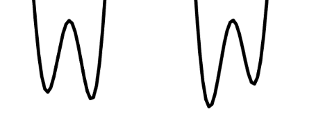

Well, I honestly think this might be a bit exaggerate. If you take a closer look
it could look like a plane waves.
Yeah it works well under some approximations, some of them are mentioned in that textbook.
The free electron model does not even consider a crystal structure. It's just a pack of fermions forming a fermionic gas, with absolutely no underlying crystal structure (unless you consider a null potential to be periodic, which is valid of course, but not really useful).
The nearly free electron model is able to predict bandgaps (as you depict in your picture below) and thus is able to explain why there are semiconductors and insulators, as well as conductors.
In real materials I think that tight binding models are more accurate (DFT) to describe the band structure. The nearly free electron model might work reasonably well for potassium, and possibly a few other metals (it kind of fails for lithium which is... extremely simple). It's the concepts that matters and how one can retrieve known quantities from the models.
Here you can see that far from bragg planes the behavior of the tight binding method follows pretty well the free electron parabola. Also, when the potential is almost constant plane waves are the solutions of the Sch. eq.Well, I honestly think this might be a bit exaggerate. If you take a closer look
I'm not quite sure what to think. If we believe that this shape looks like a plane wave, then the same shape is seen for the wavefunction right at the nucleus, so we must also accept that the wavefunction looks like a plane wave at the nuclei too. What do you think?
I also do not see how you find, based on the parabolic picture, that when the potential is constant, plane waves satisfy Schrödinger's equation.
Sorry, I had a full day...
I don't really trust that picture. Here's another one taken from Ziman's book
in between the atoms it does look like a plan wave.
To be completely honest here the author is talking about orthogonalized plane waves which are a sort of improvement of the tight binding methods. As I understood reading the book, these functions are introduced to solve the "fundamental" problem of tight binding, i.e the wave function should look like a plane wave in between two lattice points.
